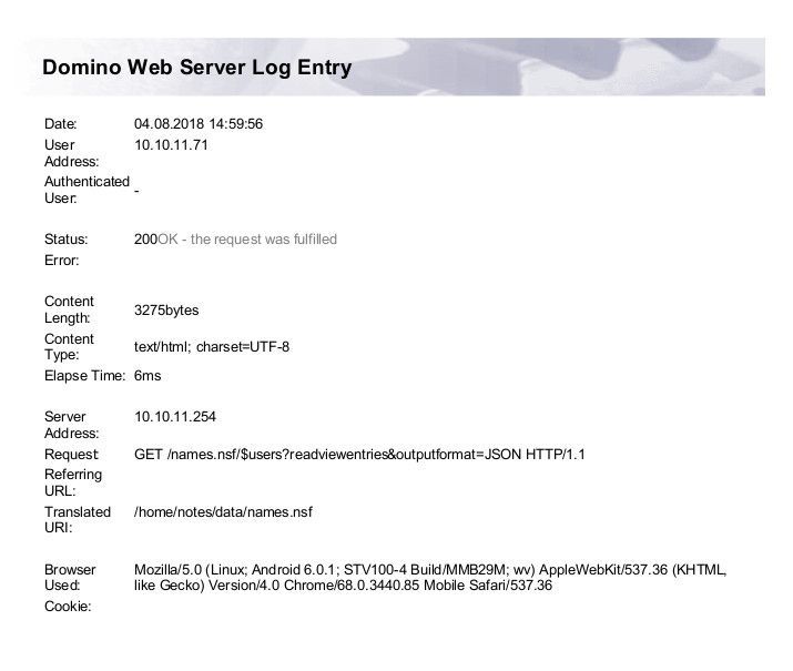

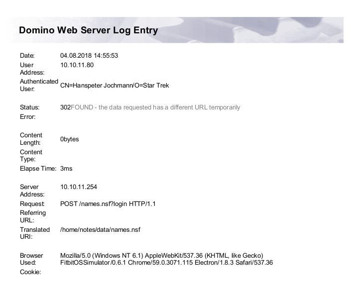

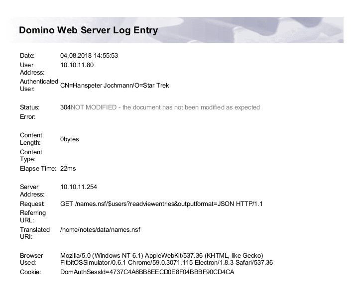

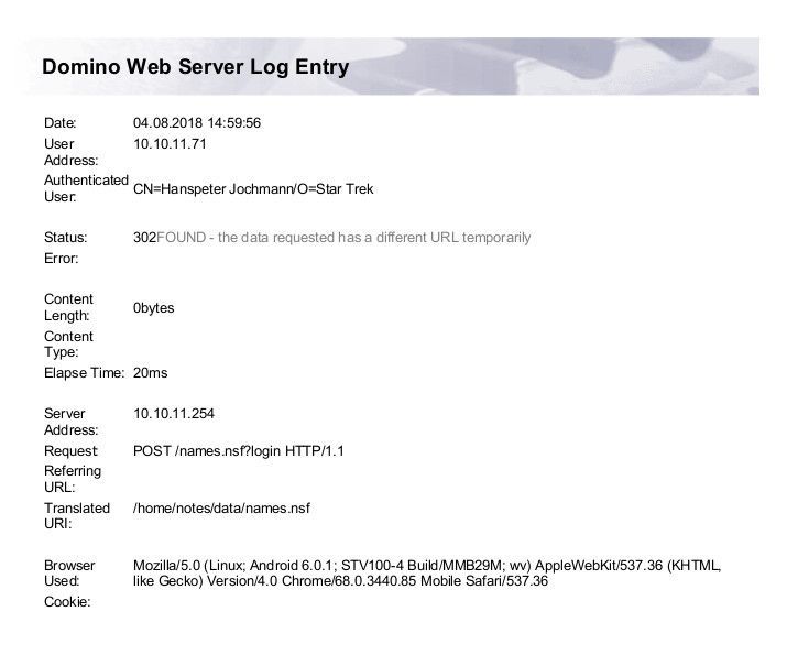

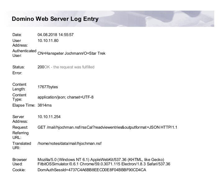

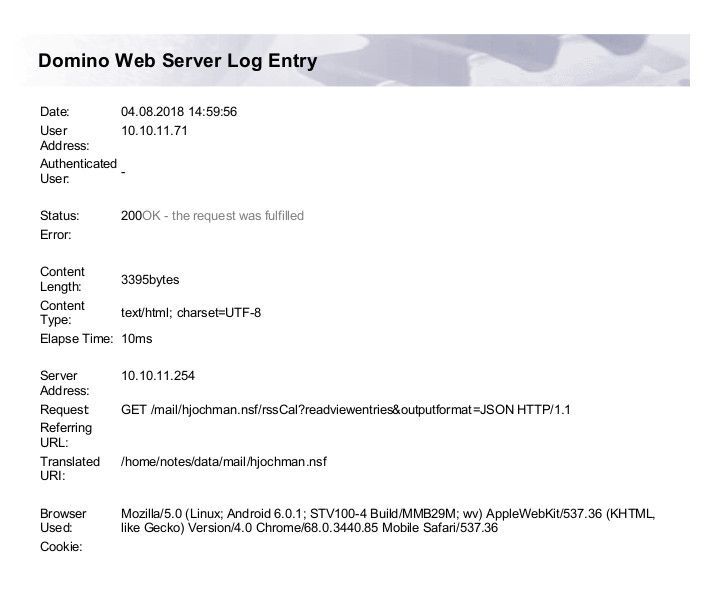

As addition here you see the requests in the web server log:
The 10.10.11.80 is the Simulator and the 10.10.11.71 is my Ionic.
Domino_Web_Server_Log__1.jpgDomino_Web_Server_Log__2.jpgDomino_Web_Server_Log__3.jpgDomino_Web_Server_Log__4.jpgDomino_Web_Server_Log__5.jpgDomino_Web_Server_Log__6.jpg
