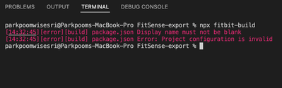

Hi! There,
I try to use the command npx fitbit-build to build and run project but the error occurs
[14:29:54][error][build] package.json Display name must not be blank
[14:29:54][error][build] package.json Error: Project configuration is invalid
Are there any solution to solve this error?

Have a look at the appDisplayName property in package.json.

Hello Peter,
The solution is work for me.
Thank you for your help
