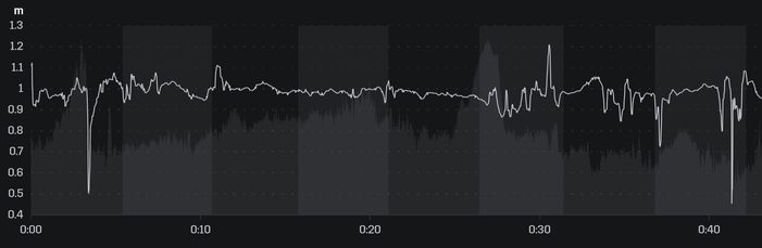

@rbittman I know Quantified Scientist but unfortunately, it's not QS who does my running and cycling but me 🙂 I test with multiple GPS devices on known routes and also on a measured running track. I also use running POD. When cycling, the distance is measured by Fitbit using GPS only (and it comes very close to the bike speed/cadence sensor data, no issues here, at least on Sense, haven't cycled yet with Sense 2). Fitbit has problems with distance on hills (no 3D-distance support, doesn't take an elevation into account), and big problems with a higher cadence as legs can move faster than arms which distorts distance calculation and steps recognition (arms not in sync with legs).
Steps are not that relevant to me as Fitbit ignores cadence. On my Sunday run, it undercounted the distance slightly (not too much, 100m - 120m on 21km route) and undercounted steps by 550 (compared with POD which is on my foot). In today's run, it was undercounted by 140 steps. Nothing significant.
Now, why the distance without GPS is so off? It's because it's hardly possible to measure distance just with the use of an accelerometer without having any other data to correct it. The accelerometer can measure distance only in a very short period of time and if not corrected it will start drifting. That's why Fitbit has a setting for stride length. But stride length for non-GPS tracking is kind of useless. Here's why:
Stride length changing during run
The chart above shows how my stride was changing during the last run. So without GPS, there is nothing to correct accelerometer drift and Fitbit must rely on the fixed stride length and try to figure out the distance based on that (it doesn't do stride x steps, that wouldn't work, it's more complicated). Hence, for some people such distance will come close to what they expect, for others, this will not work. This is one of the reasons why I need GPS 🙂
