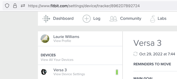

Hello @Shradha.Gautam and welcome to the Community. This will take a little work and I hope these directions are clear. The user of the faulty device needs to go to fitbit.com with any web browser and log in using their email/password. This is their web dashboard. Tap/click on the gear icon in the upper right of the screen, then Sense 2 in the dropdown. The URL has that Sense's device ID and will look like this:
The end of the URL has 12 digits and letters -- this is the serial number of that device in Fitbit's code. Write it down, then write the following letters underneath. I'm putting it in groups of 4 to make it easier to see. My Versa 3:
8962 D7B9 2724
KLIJ GHEF CDAB
Put it in ABC order and you will have the serial number of that device. This is the serial number on my Versa 3 box:
2427 B9D7 6289
ABCD EFGH IJKL
8962 D7B9 2724
KLIJ GHEF CDAB
2427 B9D7 6289
ABCD EFGH IJKL

thanks a lot for all the help. Was able to identify the box. Not sure why it is this hard though. But your answer helped a lot thank you so much.
