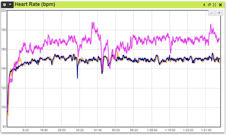

@Rami.Khalawi so specially for you, my run from December 8th, 18km, easy pace trail run :):
Three watches:
Fitbit Sense 2
Garmin Fenix 6 Pro
Garmin Fenix 7 + PolarH10 strap
Now a tricky question. Which one is Fitbit Sense 2? Not pink. It's orange. Blue is Fenix 7 (with PolarH10 which is a reference) and pink is Garmin Fenix 6 Pro. So now you've seen that Garmin may also suffer horrible HR reading (and funny, that this time Sense 2 tracked it really well).
I'm not saying that other watches suffer the same problems all time but it's not like they are always perfect either. Sense 2 tracks 1 of 10 exercises properly while Garmin 9 out of 10 but for me this is enough not to trust wrist HR (I believe I may be a bit extreme case of the user).

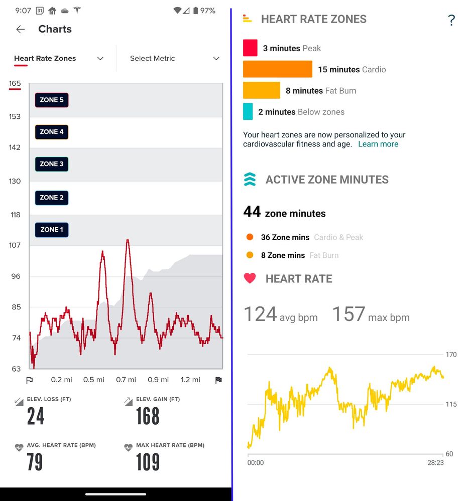

Here's where I get the absolute worst performance - when doing a power walk on the treadmill. This is a fast walking pace with arm movement consistent with jogging. (I finished the November and December iFit running challenges and am finishing the year out with a few hiking challenges). It does better for me with running, but of course far from acceptable. Here's an example from this morning where it is so far off that FitBit shows the average HR far higher than the MAX HR from the iFit band. Left side in the image is from the iFit app (band connected to the Treadmill) and the right is from the FitBit App.
As you can see, at this power walking movement and pace (3.5 MPH or 5.6 Km/H), the FitBit is not even close and the graphs don't even seem to be charting the same thing. The real max HR was 109 and the average was 79. My resting HR is 46, so 79 is not out of line for such an easy walk. But FitBit thinks the max was 157 and the average was 124. As several of us have noted before this makes nearly the entirety of "Premium" - since much of the data is based on Active Zone Minutes which comes from HR - completely useless.
The spikes in the iFit band HR correctly correspond to when the grade went to 15% (the gray area on the iFit chart shows the elevation and grade).
So in this walk, I should have gotten approximately 3 Active Zone Minutes (for me, FitBit's simplified version of "fat burn" zone is from 94 to 117). What I actually got from FitBit was 44 Active Zone Minutes. I did a second powerwalk / hike today as well, this one at 4 MPH and got similar results and now have 110 Active Zone Minutes for the day when I should have about 8.

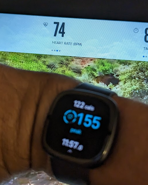

During these walks, I would regularly see this:
Over 100% off! The treadmill data, again, is from the iFit Band and shows 74 whilst the FitBit went crazy and is showing 155.
