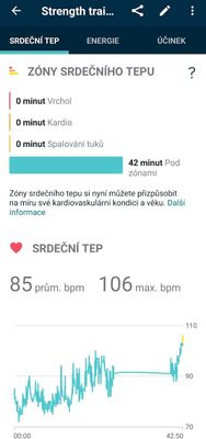

Exactly the same experience here. I train kettlebell swings and get ups, Sense 1 used to measure my HR max during these exercises somewhere around 160..170 bpm. Sense 2 measures max as 106 bpm with average at 85 bpm. Total nonsense. No active zone minutes.
