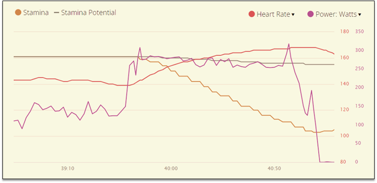

@RoyVP that is true. It's much better to use a lactate threshold to define HR zones but then one has to do an LT test to find out own LT. With Fitbit that wouldn't work because the zones are built around the age formula (old and proved invalid) and resting HR and the system won't allow full customization so you need to work with what you've given. In general, what is the purpose of zones? Zones define heart rate thresholds which indicate certain changes happening with your body and with metabolic processes. For example, LTHR indicates HR above which the fatigue kicks in very quickly and there is a more rapid drop in the athlete's stamina. It doesn't mean that below one threshold you burn fat and above you suddenly stop (which is a common misconception among Fitbit users worried that going Cardio they stop burning fat 🙂 ). It's a lot more complex and very individual. See this chart. It's a finish of an easy indoor bike ride with a sprint to the finish:
Stamina (orange) starts dropping BEFORE HR reaches LTHR but as soon as the higher output power is generated during the ride. Eventually, HR will reach the threshold and when kept the same power output it will hover around that area within the threshold zone. It takes time for the heart to accelerate. The fatigue kicks in slightly sooner (it's kind of a shock for muscles and the cardiovascular system to switch so suddenly from an easy ride to a sprint). I show you that, so you can see that HR zones are not only non-linear functions of age but the effect is "blended" between zones. So even if you don't get accurate thresholds for zones that may still work alright for the purpose.
