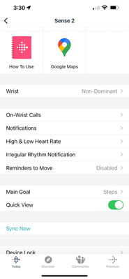

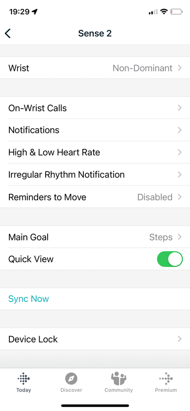

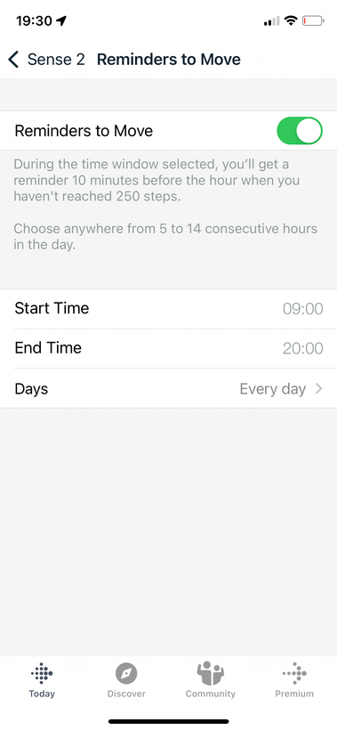

From the Today tab I select my profile picture (top left) and then select the device. On the next screen when I scroll down I can see an option listed for movement reminders. This is where it is showing a status of "disabled". However, when I click into that option the little toggle button at the top to turn it on/off is set to on and the hours/days for it to remind are selected. So it's showing as disabled despite it being switched on.
What I mean by flicking back and forth is if I go in and ensure the toggle button is definitely switched on (which it is), when I come back out of that menu it then shows a status of "on" for movement reminder. But as soon as I sync the Sense 2 to the app it switches back to disabled.
Photos below to help show what I mean.
