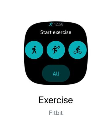

Hi @Jmussel   Are you starting your run by tapping on an icon this tile?
These are Quick Start shortcuts -- tap and go.  If you want to make changes from this screen, please do the following.  Tap on All.  Tap on Run in the list.  Swipe up on the tiny "^" on the bottom of the screen to get to the settings.  Fix your lap settings there.
