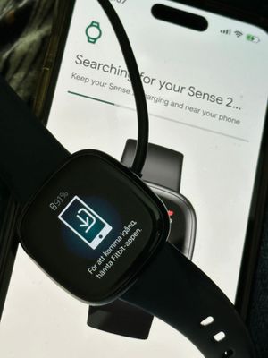

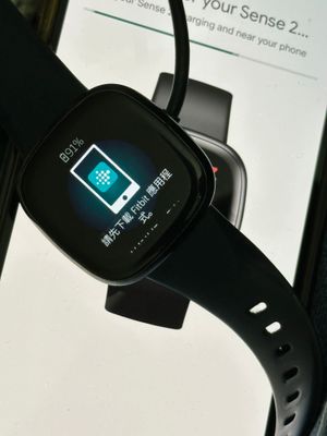

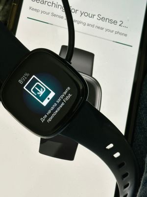

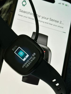

its all kinds of different languages that’s flashing across the screen.. cant even change anything nor get to settings
Best Answer06-01-2025 12:10
06-01-2025 12:10
hi the sense wont even connect to the phone…. heres some pictures
Best Answer06-03-2025 05:40
06-03-2025 05:40
Hi @momof4boys203, thank you for the photos.
The message in different languages that you see, is the setup message. It says "Download the Fitbit app in your mobile for setup".
When you perform the factory reset, this is the message you'll see.
After the factory reset is completed, you need to actually setup your device to your mobile which it seems you are attempting to do. Thank you for this process.
Make sur you are choosing the correct device in the list as Sense and Sense 2 look pretty similar.
