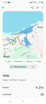

I'm also having issues with this. I walked around 61/2 miles yesterday,  it told me I'd done under 2!! Today I walked just under 5 miles, told me I've done 1/2 mile. Won't connect to my GPS. It's worse than my old versa 3.

To put it bluntly, the onboard GPS on the Sense 2 just isn't very good. As far as I understand it is mostly down to antenna placement, with the little plastic area around the heart rate sensor pointing to that being the location for the antenna. Obviously for something that requires good clear line of sight, this isn't ideal.
There are a couple of things you can do to try and improve tracking quality. The first is to wear the watch a little looser so that your wrist isn't obscuring the antenna as much, although this may affect heart rate quality.
The second and more preferable would be to enable the use of connected/phone GPS on the watch. This will require you to have your phone with you when you want to use GPS, but it will use the much better GPS on your phone and hopefully provide better quality tracking.
