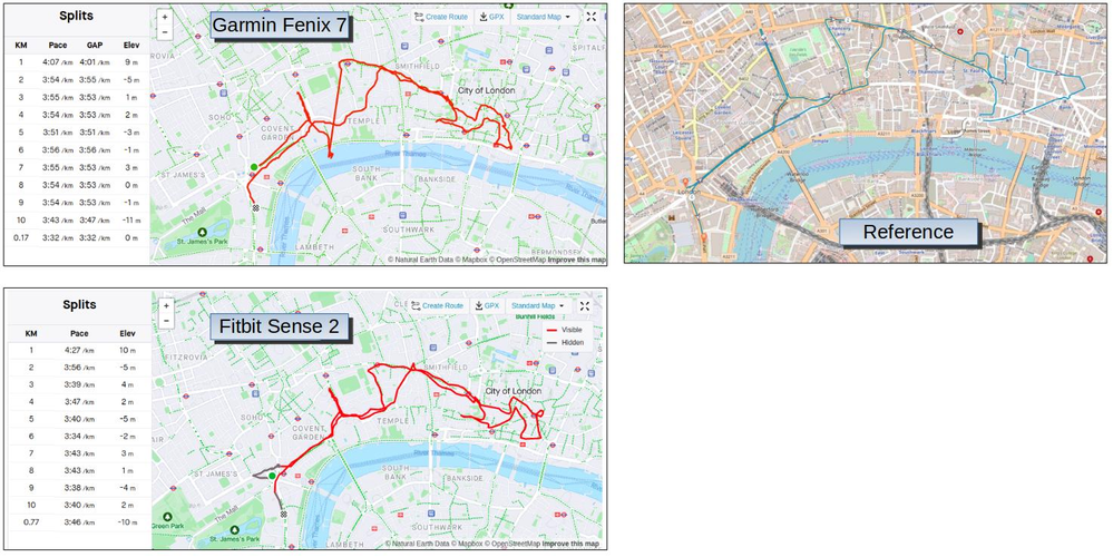

@N8teGee I think the problem with the GPS can be very "local". Using many devices, the only reliable GPS device I own is a bike computer Garmin Edge 1030 Plus. Even my mobile phone fails in some areas. I experience minimal issues with Sense 2 GPS but this may be tied to the place I live or work (two different locations, ~40 miles apart). None of those places is a big city, with no tall buildings, etc. Hampshire is 90% rural area and west Surrey are planes of small towns. However, I find areas where any device I own struggles (and Sense 2 sometimes does not do too bad a job in all the "badness"). See this, this year's London Winter Run 10k:
My Fenix 7 went totally crazy between 1st and 2nd km. In general, both routes don't match the reference route. Garmin uses a Stryd sensor for distance measuring. Garmin's GPS distance is 10.49km and Fitbit's is 11.06km. Not sure what would my old Sense do here but I don't expect a good-quality signal. The problem I usually have with Sense 2 GPS is that when it starts acting weird it doesn't recover. But all the same behaviour I've been observing on the original Sense, too. On the other hand, when I run in Hampshire where there are lots of open skies, Sense 2 loses GPS quite often in the areas where it definitely shouldn't but then again - my original Sense had the same problem. The connection time of Sense 2 improved over time (still takes a long time, though - but my definition of "long" is 30sec+) but during the last weeks of using the original Sense my GPS often didn't connect at all on this device. I find really hard to pinpoint which device GPS is worse here. For me, it's all the same. Same random issues, a long time of connection (I don't even wait anymore, just start running when my Garmin connects which takes like 5 sec).
