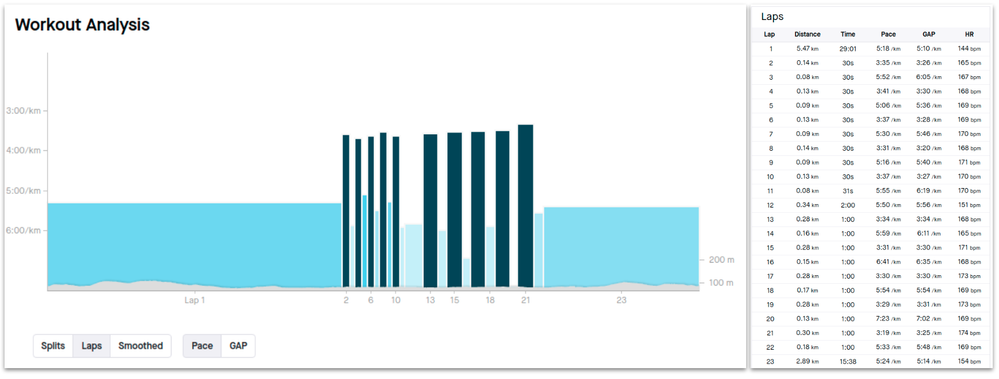

@CanadaGuy one more option is to fall back to the original Sense or Versa 3 (they are quite cheap now). They don't support automatic laps longer than 20min but after my run today with impromptu intervals 5x30s+5x1:00 I had this idea that you could do what I do for my improvised intervals - just hit the manual lap when the time comes.
Even with manual laps, I hit 30 seconds and 1-minute intervals. Mind, it will be harder to time it perfectly on the touchscreen but ±3 seconds won't really matter (that's why runner's watches need buttons).
Still, you need to look at the watch from time to time but it's doable. I've been even doing so for short all-out 10sec strides. However, you can't do it on Sense 2/Versa 4 because those watches have been stripped of all lap-based metrics (no lap time, lap pace and lap distance which are crucial for that). This also answers your question "Any chance this will change or be improved in the near future?". My bet is more features will rather be removed than added.
