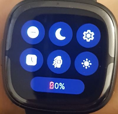

@LizzyFitbit is anyone testing those devices at all? 🤔 this is a bug that appears first time right after the very first startup when user takes watch out of box and turns it on. For a while, the battery indicator shows 0% and after some time it jumps to real value. The same happens after shutting down and restarting the device. You want to tell me that the bug that hits you in face on first startup of device went unnoticed? I'm sure you must have access to the Sense 2. Why don't you try it yourself. The bug takes seconds to reproduce. Here:
with 71% of battery which shows up a few minutes later correctly.
