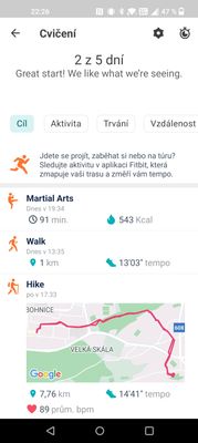

I'm having this issue during sports activities. On the watchface HR is being displayed fine (I'm using the Dash watchface by Fitbit).
However, I'm often seeing the 2 dashes instead of HR value during sports activities. During kettlebell swings, very low HR values are being recorded in the final log.
Today, no HR was measured at all during walk and during krav-maga training. There used to be reasonable values recorded for these activities before.
I've reset the watch and will see if things improve.
