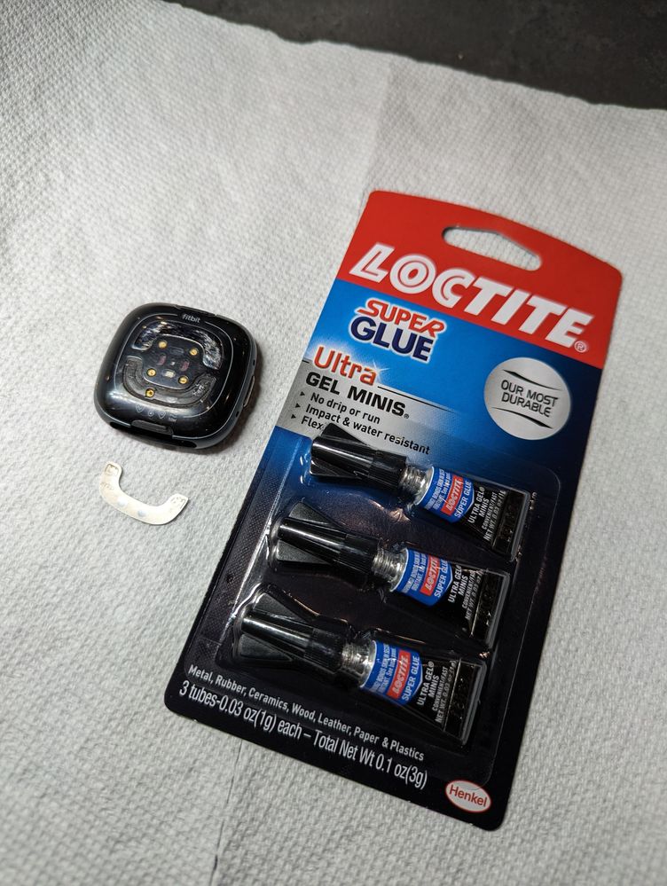

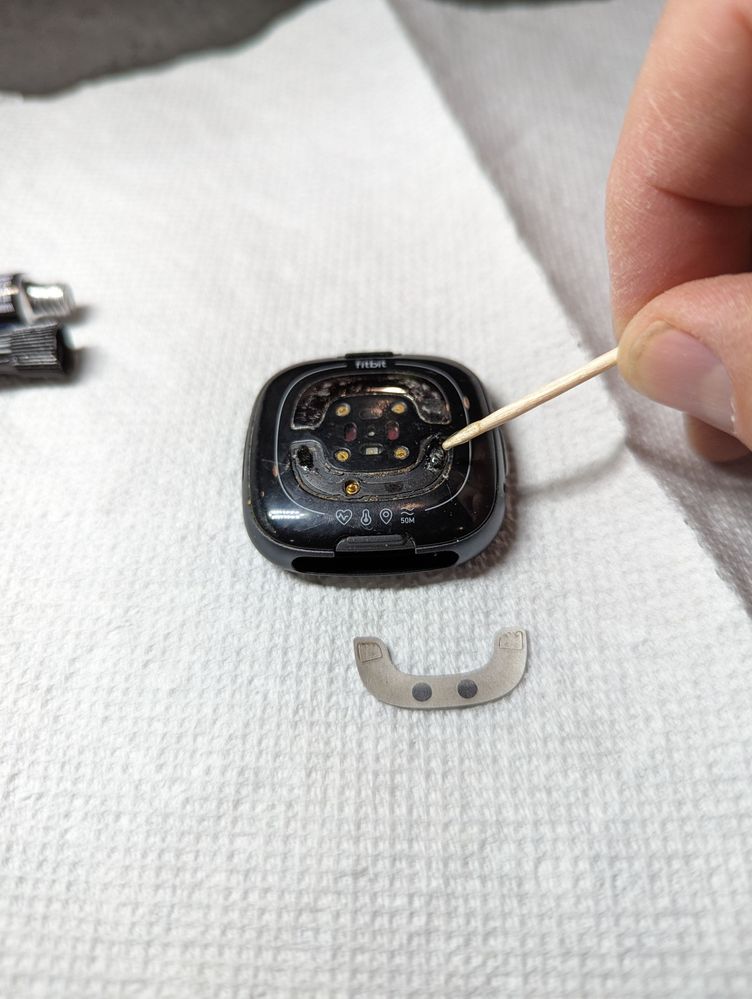

@Rl1032 welcome to the club, I'm sorry you are here.  I have superglued mine on with no issue.
I first cleaned both the metal sensor strip and Fitbit with some alcohol. I then put a small amount of super glue gel on each end of where the metal senor strip contacts the body using a toothpick, and carefully installed it.
Good luck, I hope this works for you.

Yes superglue should work well. I would just suggest that you are mindful of the little gold connecter and to not get any glue into that part.

A small dab of super glue did the trick for me.  Use a precision tip right at the edges and allow it to air dry.  Good as new.
