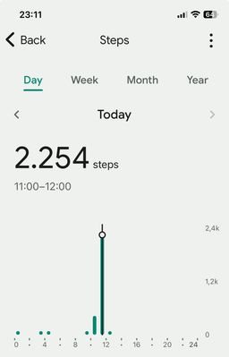

Thank you for your answer, but that's not the solution. The watch keeps the HR ok, last 2h graph is visible on the watch, no issues. The issue are just when it does a sync with the app. Not always, anyhow. Not just HR, but also steps, distance, calories. Look at this printscreens. They are from last week. Taken around 11pm. Totals steps over 4000. Hourly steps, stop syncing around noon. Second picture shows clearly that what I have In hourly steps can't be more then 2400 something, since the larger number there is 2254 and the rest is peanuts. So obviously the watch counted to over 4000, just did not sync with the app.
And this happens with distance and calories also. When this happens is like the sync process is stuck. Next day there will be no sleep score. This is what happens: after I wake up I sync the watch with the phone, the sync misses HR, but the calculation for sleep analysis starts anyhow and it comes back with no score, as there is no HR. After 10 to 15 minutes HR syncs too... way too late, sleep score is already incomplete, no readiness score or stress score either for that day.

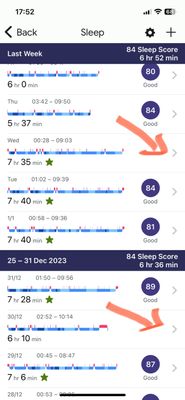

see... missing sleep score. The one on Wednesday is the day after those steps gone missing.

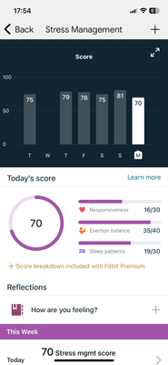

look stress score is also missing that day
