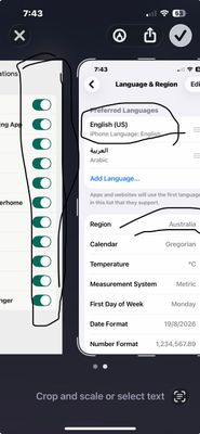

IMG_0578.pngHi Aura23,
Thanks for the suggestion! As you can see in my settings, I've already set the Fitbit app language to 'English' and my region to 'United States'.
This is exactly what triggered the fix for me—my notification list jumped from being empty/blank back to showing all 11 apps, including WhatsApp. I can confirm that as long as I keep these US/English settings, WhatsApp notifications and calls work perfectly on my Sense 2.
However, the moment I switch the region back to Australia, those options disappear again. It seems v4.65 specifically struggles with localized regions like Australia. Also, even with these settings, the actual Alexa setup still fails with a connection error for me, so that part of the bug seems even deeper. Hopefully, this helps others who are stuck with blank screens!
