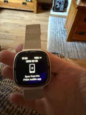

I updated my App and Tracker today but my Sense2 is now stuck on a screen that says Sync from the Fitbit mobile app.  I’ve tried resetting it, removed the App and reinstalled but nothing is working.  Any ideas?

@Bainser10- thanks, when you hold the button on the watch for 10 seconds, till it blanks or vibrates and wait for it to restart, first you have the logo and then perhaps it blanks and then what do you see? Anything else before the sync message appears? Can you post a photo.
Pushing the button briefly or a swipe down, does that change anything?
Hi again.  I tried resetting it, it does go blank, then the  logo appears and then it just goes straight to Sync from the Fitbit mobile App.  Nothing happens when I try to scroll the screen.
Good news.  I did a full factory reset and it’s worked.  All back to normal again.  Thank you so much for the help.
@Bainser10 - thanks, factory reset was the next step but you got there first! Well done.
