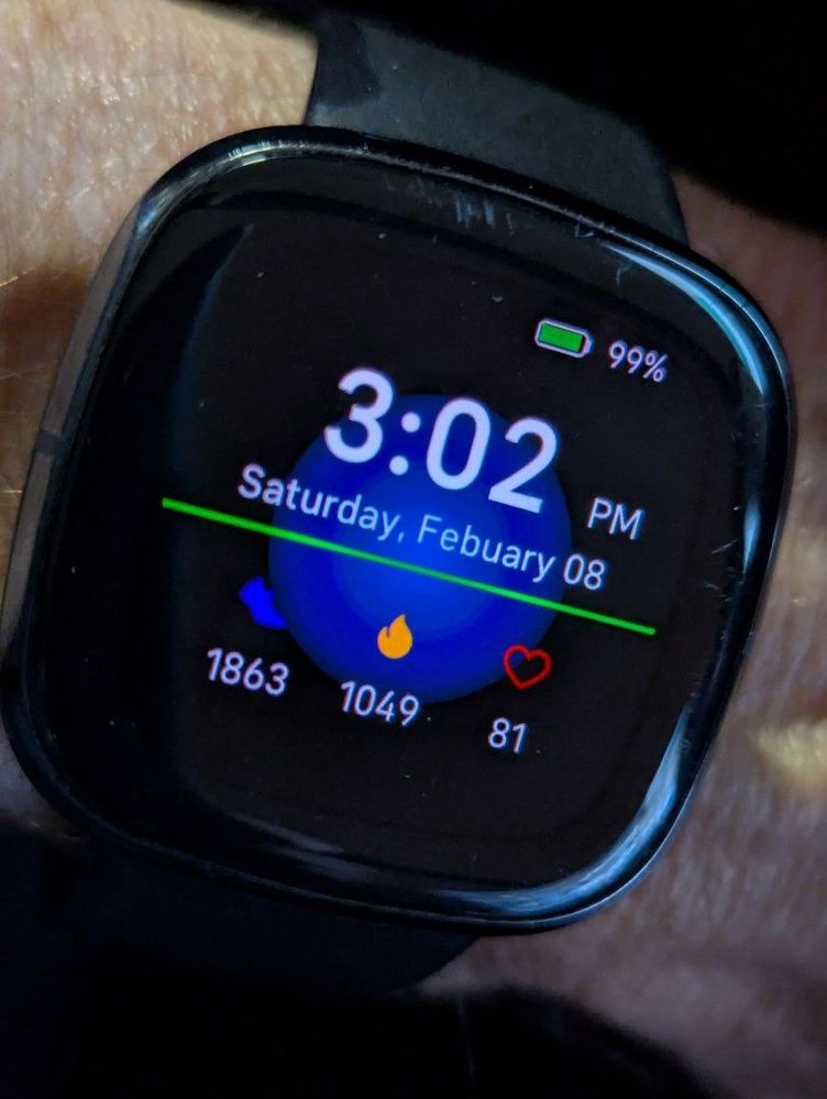

After the latest Fitbit firmware update the battery is stuck at 100% It has not changed since the update. Tried a factory reset and went through the whole 2 1/2 hour firmware update and the same thing, battery stays at 100%. The only change was when I simply shut down the watch and restarted it the battery dropped to 99% and has stayed there as of now for 2 days.
Contacted Google who sent me to the Fitbit dept, they forwarded my info to some group there, they were supposed to email me, So far crickets at this point.
