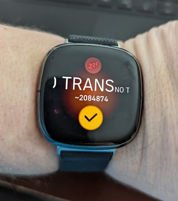

I recently updated my FitBit sense to the latest version. (I did this upgrade yesterday) and I am getting VERY weird and odd behavior. I have restarted the FitBit multiple times, and I have re-paired it with my phone.
What I am experiencing:
1. I can no longer set a workout. For example, I will select a workout, and it will try to start and then it just goes back to the select a workout screen. (This is being done on the Sense)
2. Weather looks "weird". I.E. it will have a whole bunch of jumbled words on it.

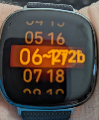

3. When I go to set an alarm, the text is very weird.
4. When my alarm goes off, it looks very, very weird and has a series of numbers and letters on it.
This is what it looks like:
I am not sure what this means, but the only troubleshooting I have not done is a factory reset.

I did a factory reset, this seemed to correct it.
Shouldn't have to do a factory reset to install firmware, but *shrug*, it seemed to correct the issue.
