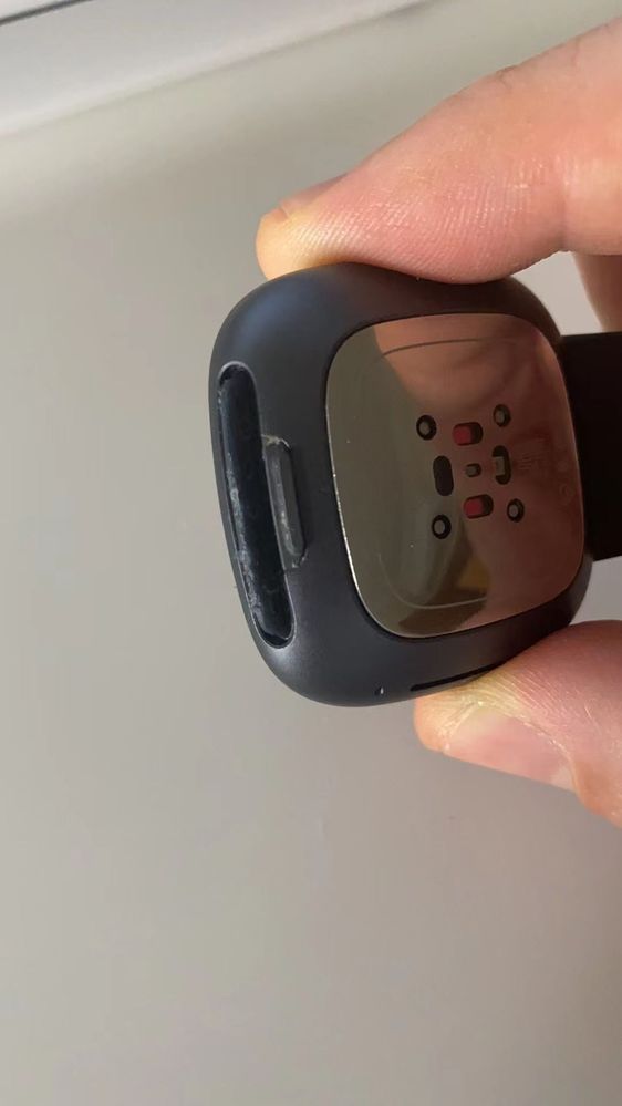

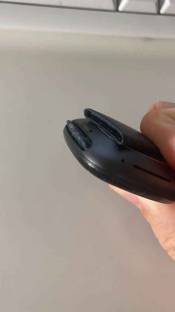

Hi @Gr4ndp4
I think that video shows the regular removal of the band, which I am used to. However, my problem is different.
Please see the photos below:
WeChat Image_20220805112853.jpgWeChat Image_20220805112900.jpgWeChat Image_20220805112904.jpg
Hi, @dincerm, thanks for the photos, I think the video demonstrates how the latch works (unless it's damaged). May I suggest you try some warm soapy water, push the latch and use tweezers or needle-nosed pliers to try and grip the embedded band part? Incidentally is this a Fitbit band or a third-party band, I've not seen Fitbit bands break like that before.
Let us know how you get on.
Cheers
Gr4ndp4 | UK
Hi @Gr4ndp4
Plier worked indeed after a bit of pull! Now I need to order a new band from Amazon (this was the original one as far as I remember).
I hope pulling out that part didnt do any extra damage to my Fitbit, fingers crossed!
Thank you very much for your help.
Regards.
