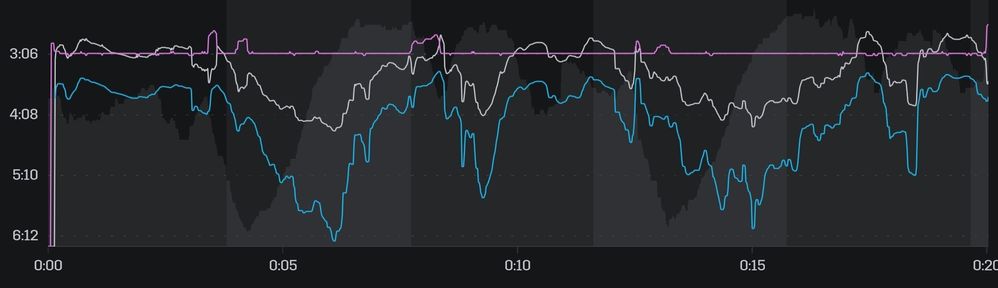

White - Stride length, Blue - pace, Pink - cadenceWhite - Stride length, Blue - pace, Pink - cadence
This is my today's 5k Parkrun race. I tend to keep cadence fixed most of the time so if my pace changes, the stride length changes, too. It is easy to see that pace and stride length are quite similar and the only thing that affects it is elevation and slight changes in the cadence. Runners who keep cadence variable (most of the runners as I don't think there are many runners who use a metronome) will make stride length even more varying. So stride keeps changing and is being recalculated all the time.

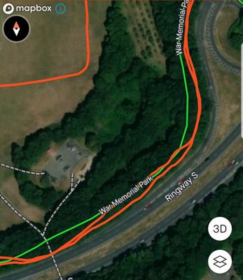

Green - where it should be, Red - GPS routeGreen - where it should be, Red - GPS route
As you can see above, on the short distance the GPS may be very inaccurate and as much as for the whole track the GPS will probably be ok (more or less) that will not provide correct real-time metrics.
