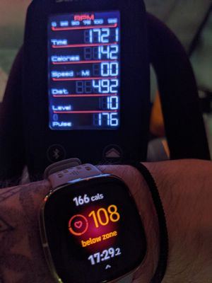

Just got a new Sense. When I exercise to raise my heart rate, 3 independent monitoring methods all show (for example) a rate of 140-145 -- the sensor on the elliptical, the readout from my Orange Theory "Burn" device, and a fingertip blood oxygenation monitor. But the (apparently worthless) Sense says "89".
I've tried multiple times, different wrists, different placements -- essentially the same result.

Ok, I’ve been wearing my replacement Sense since last week, I’ve done 2 gym sessions with it Friday and Today.
I did my usual hour weight training, then HIIT cardio session on the elliptical trainer.
Disappointed but not surprised! The HR monitor is way off, indeed my HR didn’t go over 100 on the Sense when it should have shown over 140.

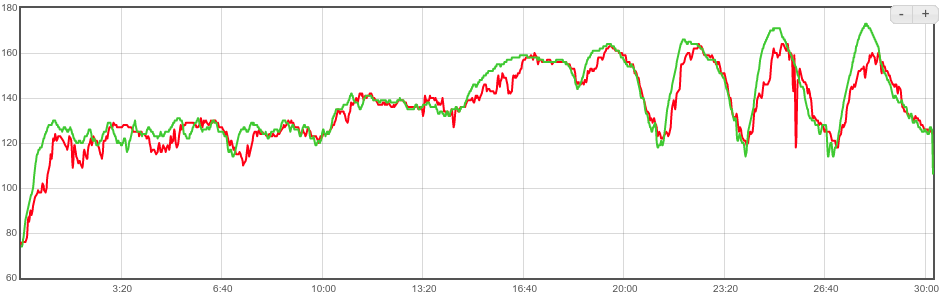

Accidentally, I became an owner of Fitbit Sense yesterday (by sharing Amazon account with my wife, long story). Well, I have some time to return it so decided to give it a go (who knows, maybe I will decide to keep it). I have done just one workout of 30 minutes. Spinning on the turbo trainer. It took me a while to extract the HR data from non-GPS activity but here it goes:
Red - Fitbit Sense
Green - Garmin Fenix 6 Pro + PolarH10 (I will test it against builtin wrist sensor later)
The session structure:
0-10min - trying to stay in the zone between 110-129bpm
10-15min - trying to stay in the zone between 129-147bpm
15-20min - trying to stay in the zone 147bpm-166bpm
Then wait to drop HR below 120bpm and pedal as fast as I can to raise HR above 160bpm-170bpm (each time slightly harder). Rest between intervals.
My conclusion:
Good:
  • This session wasn't as bad as it could be. Moreover, the "big picture" result is kinda acceptable as for wrist based optical sensor. The avg HR is very close to the PolarH10. Good enough for things like estimating energy output.
  • The response to more intense intervals is there, visible spikes where they should be.
Bad:
  • Using Sense for training with HR is rather pointless, response to changes is way too slow
  • The HR seems to be always slightly below the chest strap
  • When getting into higher HR (high aerobic, anaerobic) Sense cannot get it right. Seems like the higher real HR, the lower Sense HR.
 Fitbit SenseGarmin + PolarH10 (Chest strap)
AvgHR134BPM138BPM
MaxHR164BPM173BPM
The MaxHR difference is 9BPM. However, what is important is that in this particular workout 7% of data points (captured every second) stands for HR higher than 164BPM. Over two minutes of highest intensity has been capped. Looking at the graph, it is easy to see which peaks have been capped.
This result isn't terrible, though. It approximates calories pretty well (I believe, most of Fitbit users take special care about the calories) and shows areas of higher and lower intensity. However, the result isn't good enough to use it for training. If one uses HR zones in training then it's rather bad choice to use Sense. Moreover, so much advertised new PurePulse doesn't seem to be any better than old one. I must admit, I was expecting a lot worse result.
Today, I'm planning to test Sense running and elevate my HR above 170BPM.

@arturmeireles I'm gonna test that, too. The problem with weights training is that most of the wrist-worn sensors are useless. There are number of reasons for it but the major ones are:
- unstable placement of the watch (bending wrist affects readings a lot)
- muscle pump, especially when forearms are involved.
Why watch placement can affect readings is pretty easy to understand but muscle pump is a different story (and I don't think it's been mentioned here). Basically, when weight lifting, muscle pump effect is something that probably we all are looking forward to. After all, it pumped muscles - better pictures for social media, right? 😉 The watch however will struggle with reading accurate HR. When muscle fibers are relaxed, the blood can flow easily between them but when the fibers expand they start pinching on veins. Blood is pumped faster from your heart than it's able to go back. It may cause discomfort or even pain (rock climbers know it ;)). The problem is that it affects also HR sensor which is designed to measure the blood flow (it doesn't measure HR, you want HR - get chest strap). If the blood is forced to slow down and struggles to pass through veins this will cause not only lower HR readings but very often utter rubbish readings. The blood flow may be different in various parts of your body, too. That's why majority (or almost all?) watches struggle with HR during weight lifting. This is the reason why most of sports watch manufacturers recommend to use external HR monitors. Even my Garmin Fenix 6 Pro struggles during weight training or calisthenics (it just hates press-ups). I have never seen a watch (Suunto, Polar, Garmin and Fitbit) that could get HR right when I do rock climbing/bouldering - lots of movement, pumped forearms. That's why I use either PolarH10 or optical PolarOH1 but worn on my bicep (above forearm), less likely to be pumped during such activity. I will test lot more activities but I don't expect accuracy from wrist OHR for weights lifting, it's just barely possible.
Hi T.Sparker, thank you for posting your results. I saw a similar pattern during a recent run were I was wearing both the Sense and an OH1 arm strap. Fitbit came back with an average of 123hbpm and the Polar strap reported 121. Max HR with the Sense 158 vs 168 with the Polar strap.
I saw much bigger differences during weight training sessions. Where previously my Ionic managed to catch up with the OH1 strap, the Sense is simply  too laggy to keep pace with the OH1. In that respect the new HR technology of the Sense seems to be less reliable than the “old” sensor in the Ionic. Curious to see the results of your next training sessions.
