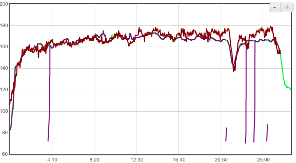

Finally, I managed to sync Sense (since I stopped using Fitbit such issues were long forgotten). Well, here's some more data.
First of all a word of explanation about PolarH10 results. The drops in the graph are caused by dying battery. Ant+ connection was breaking during my run, however, I decided to use it anyway and apart from those drops, the HR capture is accurate.

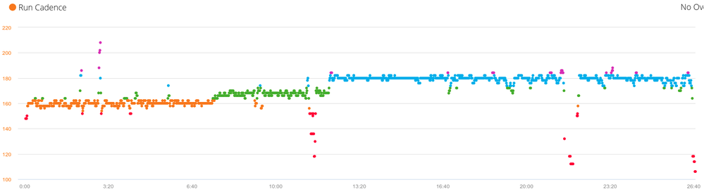

Run 5k.
3 different intensities driven by cadence of:
160spm
170spm
180spm
In general, it was pretty much steady-pace run. Due to temperature outside (-1C) it wasn't easy to elevate my HR.

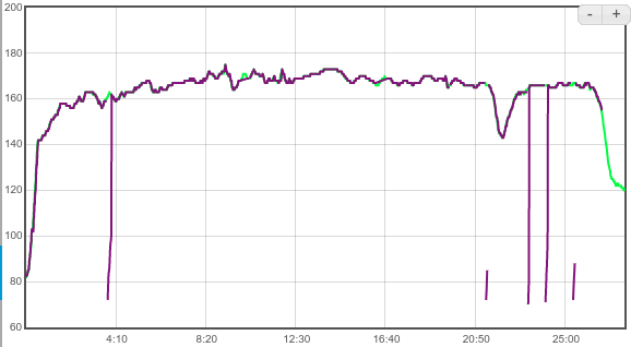

HR was captured by PolarOH1 (connected to PolarBeat app), PolarH10 (connected to Garmin watch) and Fitbit Sense.
PolarOH1 and H10 seem to have pretty much same level of accuracy (despite dying battery in H10):
Purple and green graphs overlap pretty much all the time. The green (OH1) goes a bit beyond as I turned off recording on my phone a bit later.
Now, let's add Sense to the group:
This is kinda surprising. It's a mess however somehow it follows overall trend. The dip between 20:50 - 25:00 is visible (btw, it was interesting experiment for GPS which Sense failed - stepping in place adds distance despite connected GPS). Also, very often Sense HR is a lot higher than the real one. I expect the cadence may have something to do with it:
The cadence is one of the factors that may affect wrist OHR. Despite trying to keep cadence fixed (3 ranges, orange, green, blue) it is visible that there is some noise. If this noise is not being filtered out by the Sense algorithms it may affect the results (steps may be read as heart beats). I have seen that before, too. Ionic was very sensitive to cadence noise.

It isn't that far off for this kind of run. I guess, for casual runner it will do. Training with HR zones in mind is a different story though. If I am right about cadence noise, then my run shows better results as I am running with particular cadence rather than pace. The cadence noise in my case would be reduced due to my running style. More "chaotic" runner may experience worse HR readings.

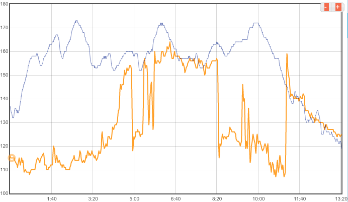

For last week I could barely find time to do any serious workout but coming back now. So, this time it's going to be quick. Two types of activities - running (5k, fixed cadence), and very short bodyweight session pretty much to cool down, done right after the run.
The run:
Orange - Fitbit Sense, Blue - PolarH10 (with new battery :))
Bodyweight workout (tracked as "Workout"):
As much as the run keeps some trend (well, lets say it does), the "Workout" HR is an utter rubbish. Within those 13 minutes Sense where never correct (maybe only during cool down at the very end). I wasn't expecting it to be that bad. The watch was worn as recommended and since it is so small and light, it stayed at the same position throught entire workout. Despite my previous test, which came up better than I expected, this one is a massive disappointment. The HR indeed is very bad. There is no consistency in the result, it's not like there is a delay and watch has to catch up etc. It just reads invalid data. Mind that my short workout wasn't very intense (it was more TUT oriented). It was:

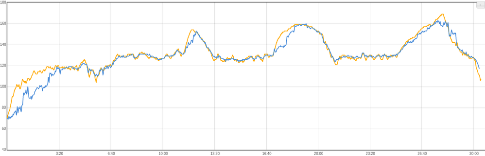

Back with one more test. This time there are more "contestants".
PolarH10 (chest strap, connected to PolarV650 bike computer)
PolarOH1 (connected to MapMyFitness app)
Garmin Fenix 6 Pro (using wrist HR, usually I don't use WHR but for sake of test)
Fitbit Sense (using wrist HR)
The activity is 30min indoor cycling. On Fitbit Sense tracked as "Spin". There are 3 peaks which include uphill intervals. Most of the time, HR should stay in the low-aerobic zone.
Colors:
Yellow - PolarH10
Red - PolarOH1
Green - Garmin Fenix 6 Pro
Blue - Fitbit Sense

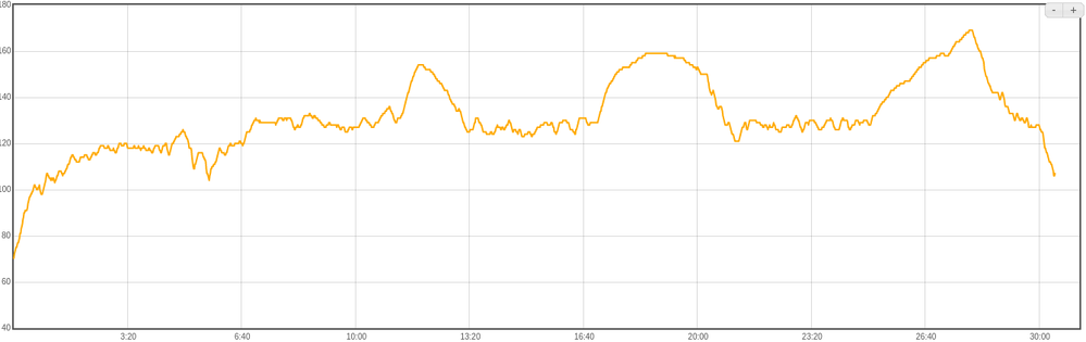

Firstly, the gold standard of the fitness industry, PolarH10:
PolarH10 is pretty much my reference for good HR.

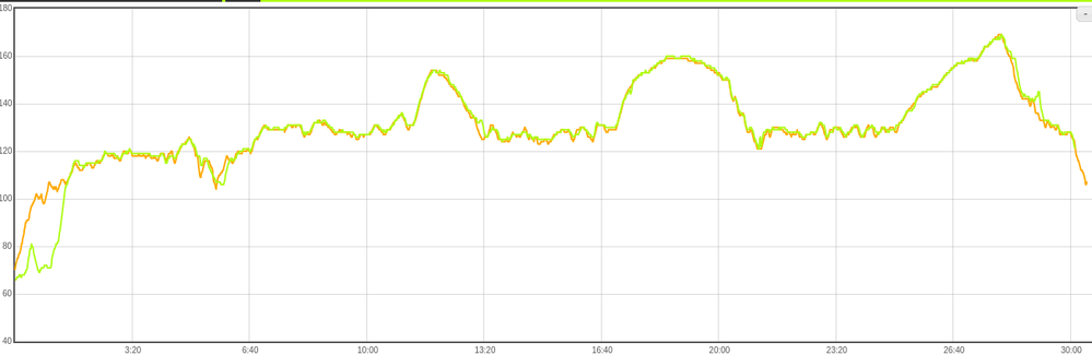

Next PolarOH1. Optical but stays very close to H10, lets call it "silver standard":
It isn't perfect but acceptable, with no unusual drops or spikes. OH1 follows H10 pretty close.

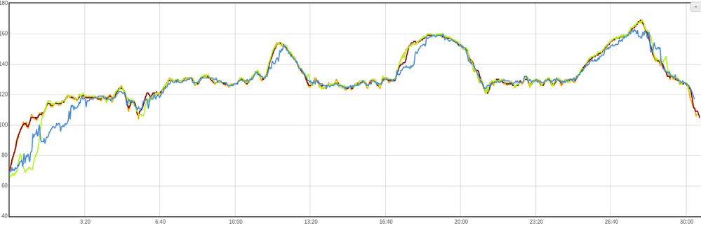

Now Garmin Fenix 6 Pro:
The beginning isn't too great. I'm not sure why. Most of the time, the result is acceptable. However, this beginning is one of the reasons why I don't use WHR. My watch is paired with H10 or OH1. Keeping HR zones in mind, I would not train using the watch HR.

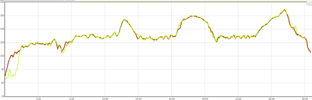

Now, time for Fitbit Sense:
Similar, 'take-off' to Garmin. Overall, it isn't horribly bad but from all the sensors, Sense is the least accurate.

H10 vs Sense:
H10 vs Garmin F6 Pro
And wristwatch stand-off, Sense vs F6Pro:

For this kind of "cardio" activity Sense may be "good enough". It follows the trend and despite it lacks the accuracy of competitors, if somebody does cardio to burn some calories I believe this HR data will provide a good approximation. PurePulse needs an upgrade.

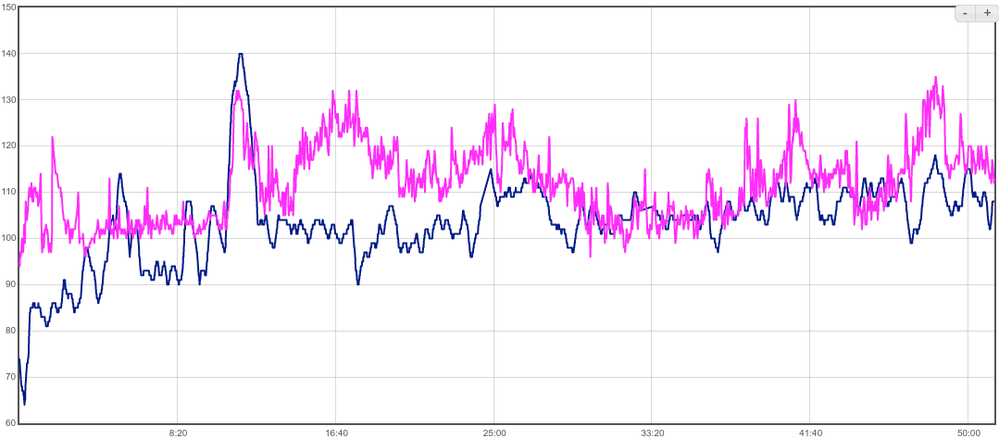

Here's my last attempt. This time low intensity hike. 5km, 52min. Sense vs PolarH10:
Pink - Sense, Blue - PolarH10
Pink - Fitbit Sense
Blue - PolarH10 (chest strap)
It may come as a surprise that this time Sense registers higher HR than chest strap. I am not surprised though. I have seen this behaviour on Ionic. In fact, Sense behaves no different from Ionic in my case. It may be just me but for low-intensity activities like walking, it captures way higher HR but for high-intensity sports it measures lower HR.
The average HR:
Sense: 112
PolarH10: 100
This results may be more important for a casual Fitbit user. Why is that? I have reasons to believe, that majority of users are into step-based, rather low/medium intensity activities and the main goal is getting into shape (and very often losing weight). It means that average user will care about the energy expenditure and the major daily activity is going to be walking.
It's pretty much it. Sense HR needs improvement. I doubt however it's going to happen. Here's why. I have already seen very same issues when I had Ionic. Now, it's like deja vu. Fitbit had plenty of time to fix HR, yet the new device comes with similar problem. It is probably the last test I've done as I have decided to return the device. Maybe next one will be better.
