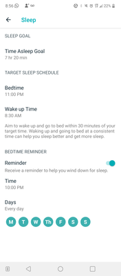

I used to be able to find the small report under the sleep tile restoration section. But the last couple weeks when I check it, it's not there. My app is showing that there is a snow report but I can't open it so and I can't find the turn off snore detect either. I do like it because it's nice to monitor even though I'm usually zero to 3% snoring.
I checked the settings on the sleep tile and I do not have turn off snore detect. It was working great for a few weeks, but couple weeks ago my sleep info is showing a snore report but the snore report is not showing up when I click on the restoration tab. I really do like the future even though it does dream the battery. But it would be nice to turn on and turn off sometime to time if you weren't wanting that data. When it was first activated I did find the turn on snore detect, but now the option to turn it off is not there as you can see in the picture. Can you help me please?

Today (9/2) like many of us, me too, now able to see Snore Detect toggle (on/off) option (one of the features available for Users enrolled in Fitbit PREMIUM program) . Thank You to Fitbit Technical team for allowing us to go as per individual's wish and brought resolution less than a week..

For the rest of the members that reported this issue, could you confirm if you're also able to see the toggle for Snore Detect on the Fitbit app? This will help me to investigate and keep our team informed of this situation. To do this, just open the Sleep tile, tap the gear icon at the upper right corner, scroll down and find Detect Snoring.

Yes I can finally switch it off!! 5 weeks of daily charging! And it even comes up with make sure your battery is charged to at least 40% before using the feature! I'm so happy I can switch it off. 3% battery used overnight vs 42! Much better!! Thank you!

Yes, I once again have the toggle to turn off the Snore Detect feature, and have. Thanks for reporting this issue.
