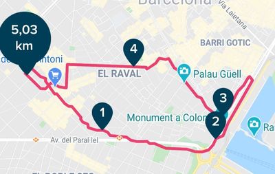

I have been using a Fitbit for a long time. Just traded the Ionic in for the Sense this weekend and saw a deviation in both pace and distance on my usual 5 k route. This morning I started the app on the Android and the exercise on the Sense at the same time and got this much difference in just 5 k!
Is there some calibration the Sense needs? This seems extreme to me.
