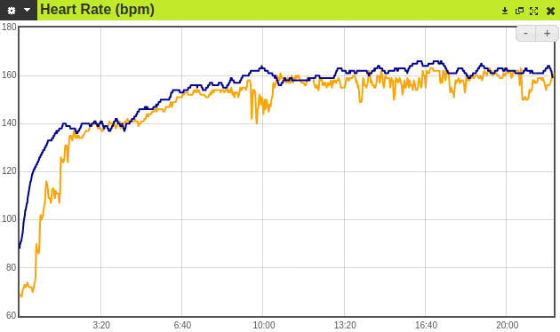

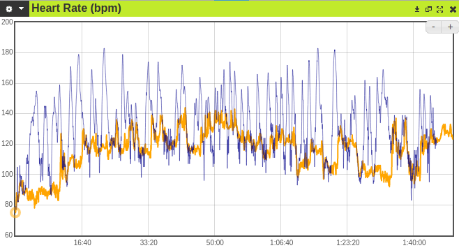

@SunsetRunner Sense sometimes gets it right, most of the time it doesn't. It's irrelevant whether it's an issue of software, hardware or both. If it hasn't been addressed until now then I highly doubt it will be ever fixed. Fitbit has no solution to it and most likely it won't have. I have posted here plenty of comparisons based on raw data. Here, two more:
Short spinning:
Blue - PolarH10, Orange - Fitbit SenseBlue - PolarH10, Orange - Fitbit Sense
Here Fitbit is almost right but not good enough as it's steady-state cardio. Sense shouldn't have any issues with tracking this kind of activity, yet it has (still, this is quite a good result compared to many other steady-state workouts I compared). On G....n I tracked it as indoor cycling, on Sense as Spin.
Bouldering (climbing):
Each blue spike aligns with a single ascent (then rest and next climb and so on). Sense just recorded whatever it wanted 🙂 Both activities have been recorded last Friday.
There is no pattern here. It just doesn't work with some exceptions when it does. No rule, no special way of wearing a watch, not even a special type of activity. I had two Sense watches and both experienced the same problems with tracking HR. Personally, I don't think this will be solved at all (or it's even looked into by the company).
