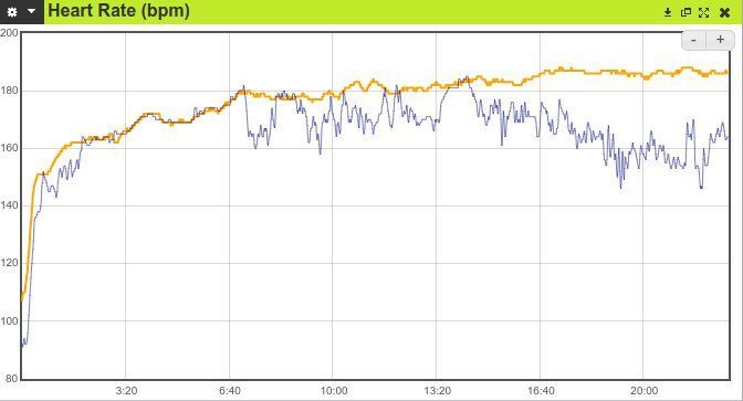

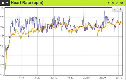

@SunsetRunner what you said is exactly a perfectly described picture of the current (and probably future) situation. For my last 3 runs, only the result of one is acceptable:
Blue is Sense and it overlaps quite well with the H10 chest strap. However, there are spikes reaching 180bpm which is probably nothing more but unfiltered noise caused by my cadence (fixed 182spm). Since Fitbit doesn't recognize cadence I don't think there is any correction to eliminate such false heartbeats (cadence taken for heart rate). Yet, this result is quite acceptable. If only little less of those spikes and it would be decent HR monitor for (at least) steady-state activities.
Then my two 5k runs (today's was sort of race).
Yesterday run. My HR elevated barely into the threshold but Fitbit (blue) shows just rubbish (also noisy spikes).
And today (local ParkRun event). In here I was running well over my threshold and stayed in the anaerobic. In other words, I gave almost all I had but Fitbit thinks I'm rather giving up 🤣
There is no explanation why is that. Sometimes I don't even get those noisy spikes and the overall HR looks very decent. Other times it's like shown above. Interesting is that it's not that Fitbit HR is always lower or higher. It may go either way and the problem isn't only for weights or HIIT but for any kind of activity. Users trying to solve the problem by skewing the big picture and looking for patterns while there are no patterns here (maybe except that cadence thing), there is nothing that we can pinpoint and tell "this is the reason". It is what it is. There is nothing that helps here and Fitbit just keeps people waiting until they can jump onto the next watch (and as usual, customers will run with hype and pre-order because who needs to wait for in-depth testing).

Thanks for your great post, @t.parker .
Your graphs with your description tell all.
I don't work on such high HR, but in the end the conclusions are very similar.

One more comparison. 10k race, pretty much all out. Sense registered just some random HR not even close to reality.
Blue -Sense, Orange - PolarH10
There are differences of 40+ bpm. I post those comparisons only for fun as it is laughable how bad Sense HR is 😛 Good that more reliable devices do the real job and Sense is just a toy.

This is like watching horror movies.. the gap is wide and hugely inconsistent
11-21-2021 10:18
11-21-2021 10:18
@t.parker , now you said it all, again. I also think, since the Summer firmware updates, that Sense is now mostly a toy for grown ups (yes, I probably took longer than you to reach that conclusion).
Remember those kids who liked to play doctors and nurses? There we are, playing with Sense and looking serious.
This new graph of yours tells a lot, in case anybody still had any doubt. As it happens, I have some even more terrible graphs on the low HR range during calm walks. Just didn't think it was worth the work to export them and make a good graphic like yours (I have not that routined), as most Sense users are more interested on higher HR during serious workouts.
