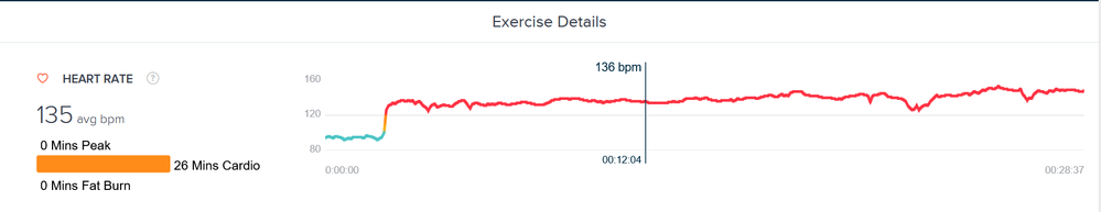

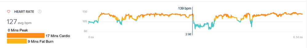

@UnguruBulan, @NazH here is something which may be intersting, but only one data point.
1. This is a ride taken last week where I experienced the HR problems I have described, that is, I sprint and my HR drops. This ride (like all but one of my rides) was done with GPS and auto figure out exercise on for biking. This pattern of HR dropping (and all the HR dependant calcs) is typical:
GPS, auto detect on
Yesterday I took the same ride/route but without GPS and I manually turned off the auto detect setting as per Naz's post:
This is more in line with what I would expect, HR rises and stays high, does not dip to 'sitting at desk' rate. Yesterday's ride was in the rain with 15kn winds gusting 25. I also denied Strava the data (I carried my cell phone with me, which I do not want to do and is a major factor in purchasing a wearable). The Strava data was in line with my pre-fitbit data (where as my Strava/Fitbit data consistently shows I'm a slacker, not pushing myself). Strava knows I am on a 34lb MTB, fit assumes I am on a 16lb road bike (for calories burned, it is close to my strava data if I take a MTB ride, and afterwards edit the bike from MTB to Road bike).
About an hour after I finished I got a notification stating fitbit has figured out my activity was biking and logged it as such.
I am still a little circumspect of the accuracy as I was pushing the highest gear pretty hard due to the weather and sprinted in highest gear (HR dips each time on second graph) I would expect a few peak minutes... but without carrying a pulse ox (which I could do) there is no way to know.
One data point, but, encouraging. I will continue to do my 30-50 minutes bikes this way (don't have to wait for GPS).

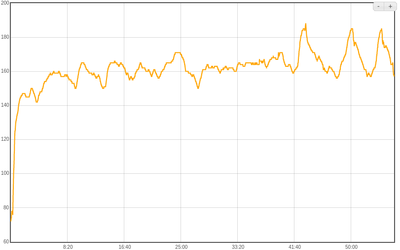

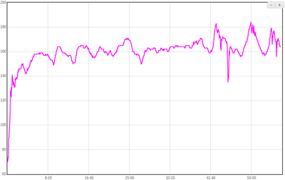

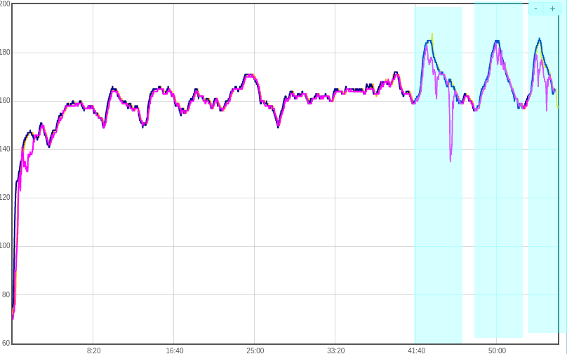

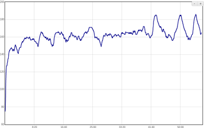

Here's another analysis.
Fitbit Sense
PolarOH1 (optical)
PolarH10 (chest strap)
Now all together:
PolarH10 and PolarOH1 are pretty much the same (I expect slightly less accuracy from PolarOH1, worn on my forearm). Sense has three areas of difficulty, however, if this was the kind of result I'm getting every time I would be more than happy. Sense for most of the time goes head to head with two other monitors. It has some difficulties during uphill sprints but that I can easily forgive. I'm impressed with this result.
Now, guess what I have done differently. Did I turn off GPS? Or worn it higher? Turned off notifications? Tighter? None of it. I just slapped it on my wrist, as usual, started Exercise->Run, and went running. No special treatment. It just worked brilliantly! This shows, that there are times Sense does a great job and the user doesn't have to do anything special. If that's the case, however, then it also means that doing anything special is not a cure. This is probably the reason why it cannot be fixed. Probably, even Fitbit has no idea what's going on. It could be millions of things that cause the issue, maybe it's the environmental thing, maybe it's skin, skin color, sweat, maybe body temperature - could be anything that changes the way the sensor works. We may be guessing and the watch anyway will do whatever it wants. The solution, if there is any, is way beyond users' abilities and looks like it's way beyond the abilities of Fitbit engineers.
