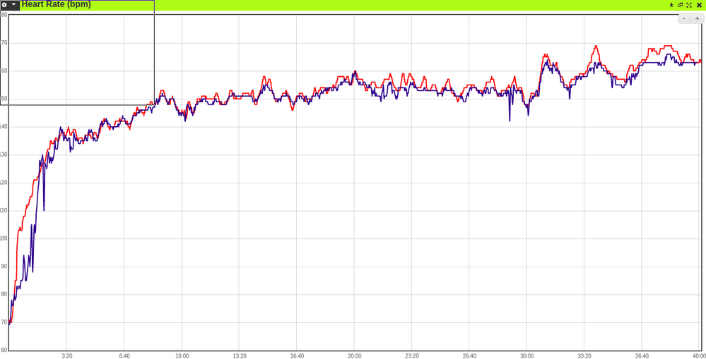

Sense is capable of getting good/acceptable readings even with a normal band, the one that comes with the watch. This is probably one of the reasons why Fitbit can't fix (or doesn't even try to fix) the issue. See session below (indoor spinning, steady-state activity but gradually increasing effort), red - chest strap PolarH10, blue - Fitbit Sense:
For a wrist sensor, this is actually not the worst. The last time I posted an analysis of my half-marathon run (a few pages of this thread back) and the HR was trashed. This one isn't exactly following PolarH10 100% and I'm pretty sure that PolarOH1 would be more accurate but it's just ok for general purpose (wouldn't use it for HR-based training but to burn some calories or AZM - should be good enough). Sometimes, I do have good readings doing absolutely nothing differently. There is nothing that indicates any factors that could improve readings. It happens randomly. Spending extra money on the different band (which I highly doubt is a factor making difference)? Nope, I'd rather use the extra money for a different device that actually works.

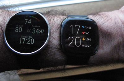

COMPARING HEART RATE READINGS BETWEEN FITBIT SENSE AND POLAR H10
The Polar H10 chest strap is considered the most accurate heart rate (HR) monitor fitness device in the market, with a error of +/-2 bpm or less most of the time, used by many reviewers as the standard against which all other fitness devices are compared to.
The 3 photos show a Fitbit Sense and a second watch paired by bluetooth with a Polar H10 (unfortunately, Fitbit watches do not pair with external HR sensors, like the H10). They show heart rate readings from both devices in 3 different moments during an easy walk on flat ground. The Fitbit Sense was weared in two different positions and a proper band tightness, all already tested many times as providing the most accurate HR values Sense can give. During the walk, sometimes (less than 50% of the time) Sense showed reasonably accurate HR values, but, for several times, it suddenly increased to absolute nonsense values, for no apparent reason. Some of these HR values are shown in the photos.
Photo 1:
Sense: 140 bpm
Polar H10: 74 bpm
Estimated real heart rate: 72 to 76 bpm.
Photo 2:
Sense: 129 bpm
Polar H10: 74 bpm
Photo 3:
Sense: 133 bpm
Polar H10: 78 bpm
Estimated real heart rate: 76 to 80 bpm.
This post is mainly for the new or prospective Fitbit Sense users, but also specially dedicated to those members of the Fitbit staff who still insist that "Sense heart rate accuracy is not a known issue". Most Sense users in this forum already know that for quite a while, at least those who have been following or participating in this or other similar threads/topics.
Photo 1
Photo 2
Photo 3

@Irish57, reading many users posts about these topic, it became quite clear to me that Sense HR values are lower than the real values on high intensity workouts with high heart rates, but on the other end of exercise intensity, as is the case of an easy walk with low heart rate values, Sense HR values have this awkward behaviour I posted, quite the opposite of hard workouts. Unfortunately, none of them is satisfactory.
10-27-2021 12:16 - edited 10-27-2021 16:56
Just to make it clear: my post above (with the 3 photos) is about what happened in this walk and is similar to many other walks before. But sometimes Sense HR values are reasonably OK during the whole activity. Why? It is this apparent randomness of Sense HR behaviour that makes it so unreliable on HR for someone who wants at least accurateish heart rates the whole time.
