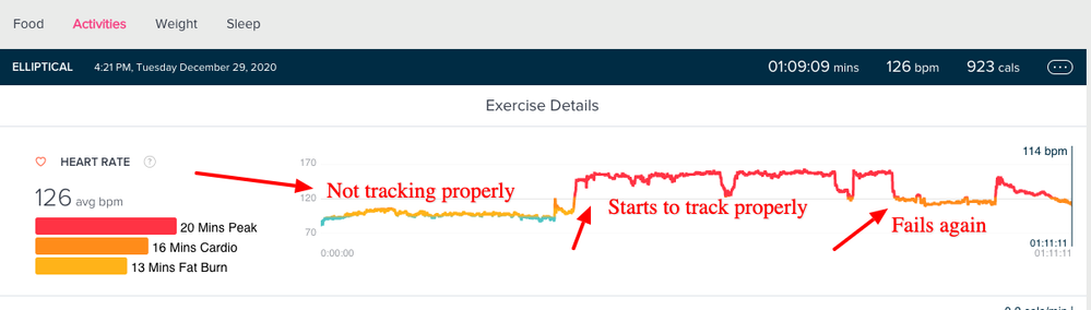

This is a KNOWN issue in the community, but it is something that Fitbit has turned a blind eye to. I have researched this extensively and the problem is with the Sense and what happens is that your heart rate will not track properly until about 20-25 minutes into the exercise. The only caveat is if you stop exercising, rest for 10-20 seconds, and then resume, it will *sometimes* start to track properly. However, it will drop off again and stop tracking the proper heart rate. This is consistent with every time I exercise. Because Fitbit never acknowledged the problem (only says, we will improve), I was forced to buy an Apple Watch and abandon Fitbit after 10 years. It is disappointing. Fitbit-Activities-Elliptical.png

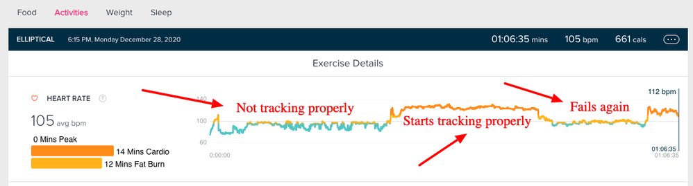

Here is another example. The thing that annoys me is that Fitbit has access to this data. You can clearly see that there is an issue. Many users are reporting this and yet Fitbit will not acknowledge that there is an issue. Fitbit-Activities-Elliptical.png

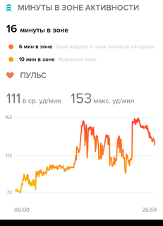

I really like my Fitbit Sense but extremely disappointed and frustrated after each workout. That's an average difference between Polar and Sense. What the hell, really?
Screenshot_20210107-183941_kindlephoto-106360915.pngScreenshot_20210107-183949_kindlephoto-106406641.png
