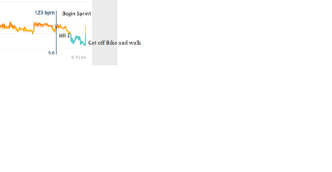

I ride the same routes daily, 30-50 minutes, presumably with similar HR at my 'exertion points' which normally sends me from cardio to peak... but, all too often it goes like this...
Notice that I begin the exertion , HR should (and frequently does) increase, but here it falls out of the zone until I get off the bike... then it jumps. So, it is in there somewhere and I think there is a fix. Unfortunately FitBit won't solve a problem which is already 'solved'.
@SunsetRunner I'll do an outdoors bicycling exercise (today or tomorrow), and will report back. I wonder if that HR jump is specific to that exercise...

But, I just reviewed my activities and there is no way HR is accurate. It literally drops 50 bpm when I start my sprint more often than not (but, when it doesn't I usually go into peak zone, 151, for a few minutes).
It is beyond discouraging that while pushing myself on my 34lb MT bike my heart rate drops from high 130's - mid 140's to low 80s. It basically renders the device useless in my opinion.. In reality I'm heading towards my peak zone, Sense shows an HR similar to sitting at my desk.

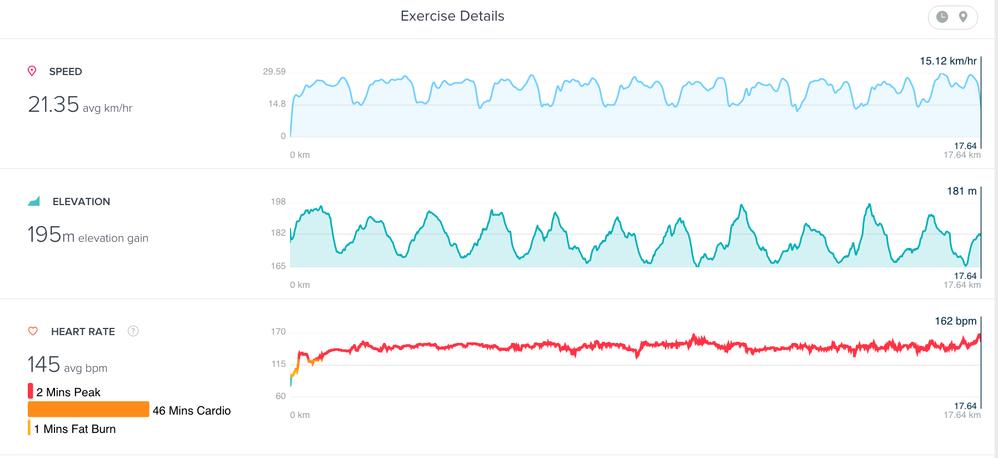

@SunsetRunner I've done my bike exercise test today... 11 laps on a ~1.6km road circuit, uneven terrain... unfortunately/fortunately I did not see the issue you're seeing. I've done a sprint on the last km or so, and the bpm, as expected went up and my Sense seemed to record it accordingly.
Here's the details (btw with that occasion I noticed the elevation isn't recorded properly, should've been 11 identical figures)
Bike training 11 laps x 1.6km road circuitBike training 11 laps x 1.6km road circuit
Sense since Nov 29th 2021 (with IPhone 6), firmware: 44.128.6.17.
