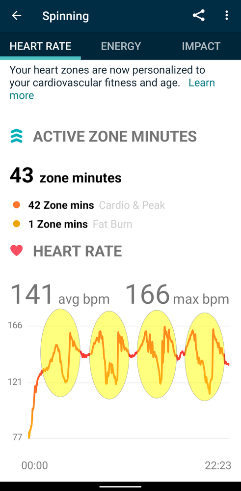

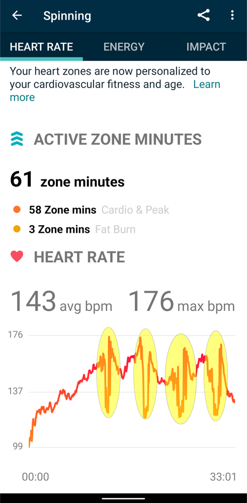

I have the same issue - I've had this Sense for about a month after several years with the Ionic (switched after recall).
It appears to be a significant step down in terms of HR monitoring.  Mine has shown real inability to measure high HR and flips to a lower heart rate during the most intense periods of my workout.  Here are three images of HIIT spin sessions.   The areas highlighted in yellow are my peak exercise periods - my HR should be 170+ (and does register at that level with another independent HR monitor).   It seems to get confused, drops impossibly quickly to "fat burn", when it should be "peak", and after a while jumps even more quickly back to "peak" again.   These highlighted areas should be inverted on the HR chart.  I picked three separate sessions - so very reproducible.
I'm not relying on this for any medical purposes - but for a "fit" bit, i expect it to at least in general terms understand the intensity of my fitness activities.
Fitbit - any ideas here?  Is there a solution on the forums other than "wear it tighter/looser" or "clean the sensor" or "restart your device"?
