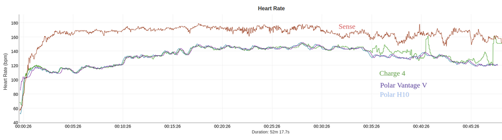

First test
Comparison: Fitbit Sense (left wrist), Fitbit Charge 4 (wright wrist), Polar Vantage V (right wrist), Pixel phone reading Polar H10 chest band
As you can clearly see the Sense measurement is nonsense (no pun intended). Charge 4 for the first 35 mins was actually spot on but then started to show anomalous values.
Polar optical sensor matched the H10 chest belt.

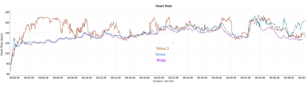

Second test
Comparison: Fitbit Sense (left wrist), Fitbit Versa 3 (wright wrist), Polar Vantage V in my hand paired with H10 (the setup allowed to wear V3 and Sense in the optimal positions in the wrists)
In this test Versa 3 this time is completely wrong while Sense sometimes is not too bad but far away to be considered precise. Then, like the Charge 4 in the previous test, at 35 mins mark it went nonsense.

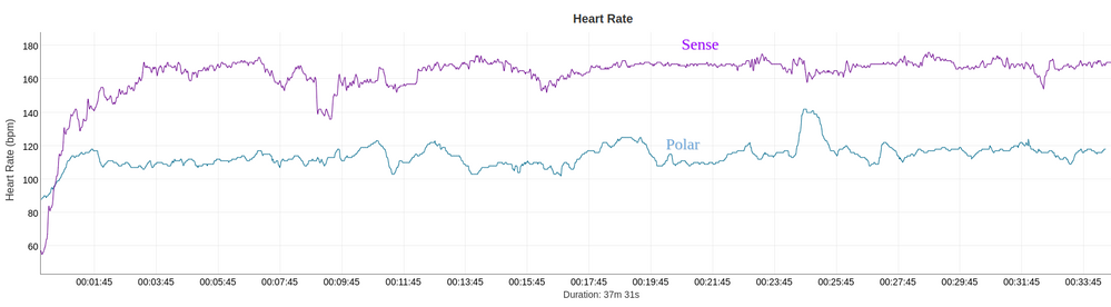

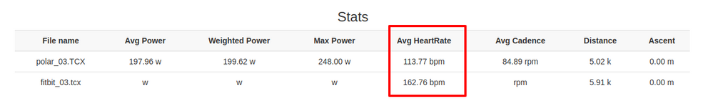

Third test
Date: November 3rd
Comparison: Fitbit Sense (left wrist), Polar Vantage V (optical sensor, right wrist)
So, the average HR of Fitbit Sense is higher than the peak value measured by Polar.
Just for sake of clarification the HR measured by Fitbit is completely wrong as this was a very slow little run at an average pace of 6'40"/ km

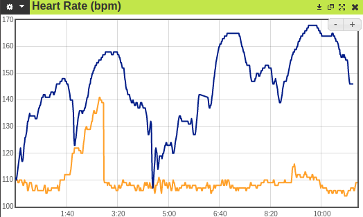

@Giampi71 what I find surprising is that without doing anything special but using the watch as usual it actually can provide good enough readings from time to time. Most of the times, I get garbage like this (which I documented here plenty of times) (ORANGE - Sense, BLUE - Garmin + PolarH10):

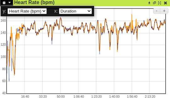

But then there are times Sense actually can make sense:
True, that the charts above are not perfect and there are areas Sense couldn't figure out the HR but if we are talking about wrist HR sensor and two trail runs (variety of surfaces, unstable weather, etc.) so I am quite pleased with such result. I'd say - close enough. I still wouldn't use it for HR zones-oriented training but if I just wanted to know some approximation then this is acceptable. Interesting that sometimes it's almost doing well even with higher intensity training, like this:

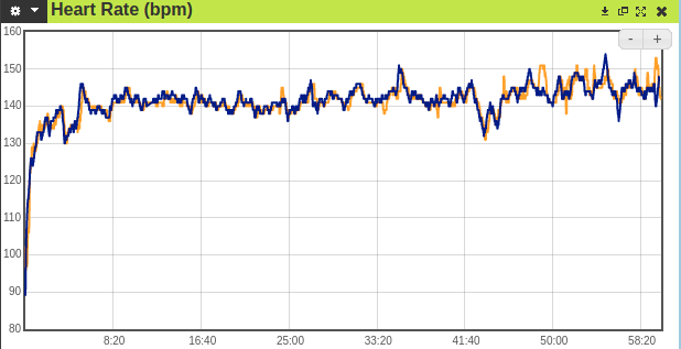

The training above shows 7 intervals, each one has to go into anaerobic, then cool down into recovery/endurance. Sense apparently has issues with registering higher HR. What I expect here is probably some aggressive smoothing algorithm that filters out high-freq signals. If only the spikes were reached, that would be quite decent reading (let alone the beginning, again I don't expect wrist HR to be always spot-on).
And it would be alright if not that it's like 1 in 10 times that I get a decent reading. As I said, they come out of nowhere, I don't do anything differently. Sometimes exactly the same run (route, pace, controlled HR) gives different results. Sense can do a good job from time to time. Moreover, sometimes I just put it on, don't care how I wear it, whether it's in the correct place, tight or not - just let it be and surprisingly, it comes out alright. There is nothing really that may help to figure out what was done differently and why 1 in 10 times the readings are good enough. That's why I don't think it is fixable (maybe except for the spikes not being registered - if it's an algorithm, it's fixable).
