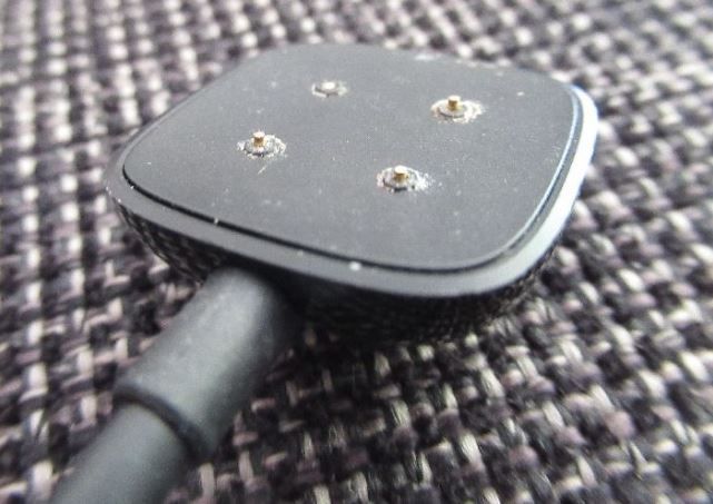

hi GWoodSGN
There is a well known problem with the charging cables that one of the 4 contact pins keeps getting stuck in the down position as per the attached photo.
This stops the cable from charging the watch. I am now on my 5th cable but find that if you plug in the cable to the watch before attaching the USB end to the power supply seems to have fixed the problem. Check your cable to see if the pin is stuck down and if it is then hit Fit Bit up for a new cable as many people already have.

There is a major problem with the Sense charge cables. Look for a pin that
is recessed.

Thanks for the details and pictures provided, as well as the steps tried on your end. I understand where you're coming from and I'm sorry for this inconvenience. I appreciate your feedback and we'll keep working to improve our devices, and the experience with them.
