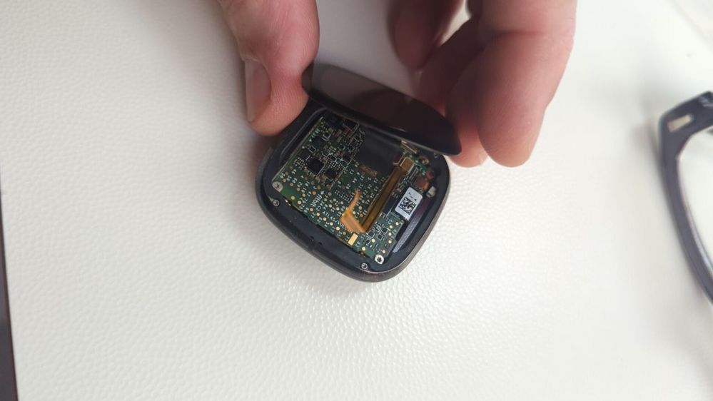

Upon verification it turned out, as easily expected, that the sealant was very dry, hint of very poor quality.
However because of gravity force when the display feel down it broke one of the wires and it turned out to be the one connecting the NFC installed in the display to the motherboard. As my wife doesn't use NFC (our credit card is not supported by Fitbit Pay) I simply removed the flat cable, added some liquid sealant and the watch is back in action. Below some pictures taken during the repair.
I don't know how water resistant is now the watch but honestly I feel that the application of the sealant as I made it is way better than the poor quality one used by Fitbit.

@Dopovo   What sealant did you use?  There are other users who say that their screens popped off, but never got their Fitbits wet or did anything else.  I think your experience can help other users.
Laurie | Maryland
Hello @LZeeW ,
Thanks for your question. I used T-7000, a sealant i used successfully to repair also a couple of phones.
