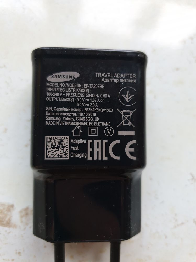

With Samsung's original fast charger, the "slow charge" indicator will still appear. If that’s not enough for him either, then maybe Fitbit should provide him with a separate charger. I'm very tired of Fitbit. Charger supplied with S9 + phone:

I use my Samsung charger and haven't seen this message.
I did find an old wall wort I had and was able to replicate.
