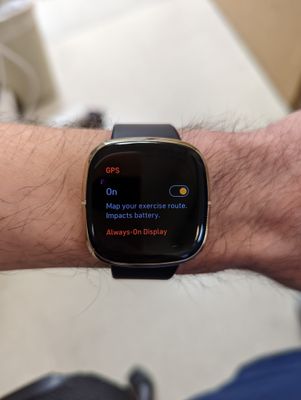

Hi @Honulii  - on a Sense you can turn GPS off for an exercise, if you swipe up there is a setting on the watch.

@Honulii  - On a Sense
  • Swipe the watch face to the left and select the Exercise App, eg Walk,
  • Swipe the watch face up and turn off GPS.

@Honulii @ After selecting an exercise that uses GPS (I did walk) scroll down and you'll see the GPS option.
I'm curious, but during that tennis session, was it 90% at the start and 25% at the end, how long was that for, was GPS on, was always-on display on, what's your screen brightness?
@eezeepee  Ok, I see the GPS option in walk.  The customer service person made it sound like GPS was ALWAYS on for any exercise and "Bootcamp" is the only one that I will manually turn the exercise mode on, the rest I leave to auto recognize (walk and tennis it recognizes it as an "aerobic workout" or "sport").
