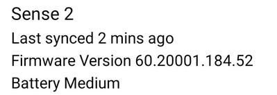

I have the same issue with my Sense 2, purchased in July 2023. None of my other Fitbits have had this problem with syncing. The only solution I've found is restarting my Fitbit as suggested, but it's kinda tiresome. I believe I'm on the latest firmware version, as below, for the Australia/NZ region. Thanks!

@SunsetRunner - thanks, that version should work, make sure you don't have more than one Fitbit app device running, and that phone battery savings is not shutting down the app, that might help.

@Guy_I've only got the Sense 2 connected to the app, so that should be fine. As far as I can tell, my phone isn't turning off syncing, but I'll do some more digging around. I'll let you know if I find anything quirky. Thanks.
EDIT: I just looked at the Bluetooth pairings on my phone, and even though my old Versa isn't charged, and was disconnected from my Fitbit app and account, it was still showing as a 'paired device'. I've now removed it, so will see if that makes any difference. SO WEIRD!
Hi @Guy_ , I've been monitoring this since my last response (and disconnecting my old Versa from Bluetooth). I've uninstalled the Fitbit app on my phone and reinstalled. The app is set to never sleep. I'm still having to 'reboot' my Sense 2 multiple times a day in order to get the Weather and Sleep settings to sync. (These are the ones causing the issues). I've also removed and reinstalled the weather app multiple times. I've not had this issue with any of my other Fitbits. Do you think it's the apps, or the watch itself?! Thanks!

@SunsetRunner - as you have a Sense 2 and this is the Sense 1 forum have a look on the Sense 2 forum (and perhaps continue posting there). Others have noted your problem and it was thought to be related to the later firmware, not currently available, but it may be more general as you don't have that version.
