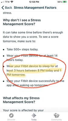

Im wondering if it’s because I go to sleep before 8 o’clock? What time do y’all go to bed? Something I read told me to get my stress score we must sleep at least 3 hours between 8pm and 1 pm the next afternoon. I checked back and EVERY DAY I GOT A SCORE? I was asleep after 8 pm, which is LATE for me. I might test this theory staying up after 8 tonight, see if I get a score. If so, FitBit needs to fix that!
Best Answer11-14-2020 08:08
11-14-2020 08:08
We must go to bed *after* 8 pm in order to see stress score. THAT is the “trick@, and needs fixing! My bedtime is 7:15, but after reading about stress score, and applying my own intelligence, I’ve figured it out. No resetting, no uninstalling... stress score just WONT WORK unless you go to sleep after 8 pm.
check your logs, guys, you’ll see.

So, this IS the case. I got a stress score after forcing myself to stay up until after 8pm.
im peeved and want FitBit to fix the requirements for getting a stress score. It didn’t say ANYWJERE that I would get a stress score as long as my bedtime is AFTER 8 pm!

I’ve never gone to bed before 8:00 PM, so I can’t confirm whether or not this is the root cause. Even if you go to sleep before 8:00 PM, you should still meet the requirement of sleeping with the Sense for 3 hours between 8:00 PM and 1:00 PM.
Best Answer11-14-2020 12:17
11-14-2020 12:17
I wear mine 24 hours a day. I tested and found this is my reason for not getting a score.
I absolutely agree, it SHOULD still calculate the score with going to sleep before eight, but it doesn’t.

I am in the fortunate position to be able to change my bedtime/wake up time by 45 minutes, so I will keep everyone updated if this continues to work for me.
i fully expect it to, after my experiment. I’ll attach the screenshot that gave the input that led me to my conclusion, here’s hoping it helps you. Good luck!
Best Answer11-14-2020 12:43
11-14-2020 12:43
I’ve actually been getting a stress score for some time now, by following that screenshot you shared (which I originally shared in the other stress score thread).
