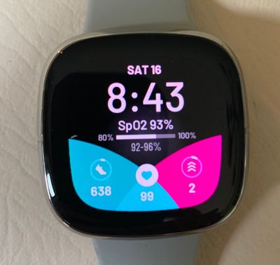

This is what Dr. Conor Heneghan, Fitbit’s Lead Sleep Research Scientist says about Fitbits SPO2 feature.

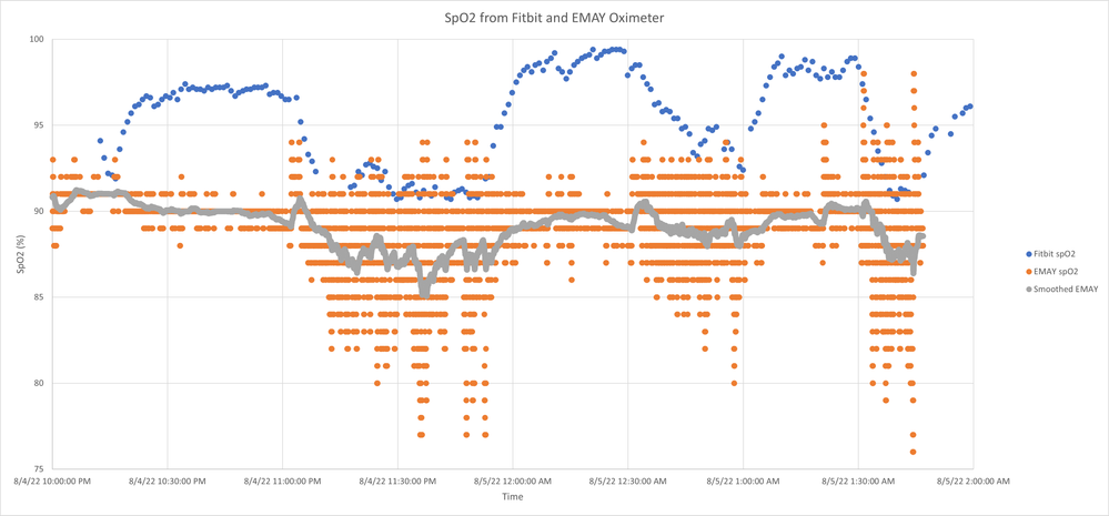

So I wore my EMAY finger oximeter last night for a few hours in order to compare it against the FitBit. Something is definitely off.
For what it is worth, I had my daughter - who currently has Covid mind you - put on the EMAY finger oximeter for 5 minutes yesterday and her readings were between 99 and 97.
The chart below shows SpO2 data from the Fitbit - obtained through the Fitbit API - the raw data from the EMAY device, and the EMAY data with a 5 minute exponential moving average applied.
The Fitbit was on my left arm. The oximeter was on the index finger of my left hand. Yes, my finger oximeter readings get real low - sleep apena sucks and I'm waiting on a CPAP machine.
I tend to believe the data from the finger oximeter as in the past it has largely agreed with data collected during sleep studies, and I've tried it on other family members whose data looked much more normal.
Best Answer08-05-2022 09:42
08-05-2022 09:42
Since fitbit says they give a relitive reading, let's look at the graphs. Fitbit does seem to follow the trend.
There must be something we are missing, the FDA approved, it was designed with the help of the medicke community, and in a few cases a users doctor understood what they where looking at.
Best Answer08-05-2022 09:55
08-05-2022 09:55
They say the give a relative reading for SpO2 variability, but the intraday SpO2 gives every indication of being intended to be absolute value.
I draw your attention to the API documentation: https://dev.fitbit.com/build/reference/web-api/spo2/
There is no mention of it being a relative value. The only references I’ve seen to relative values have been as it pertains to SpO2 variability, not the max/min/avg values that are reported out on the watch or the time series data available from the API.
The fact that it is FDA approved means they jumped through the necessary regulatory hurdles to get approval. This unfortunately does not necessarily mean it is accurate.
