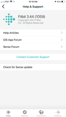

@Mistykayp As @Gr4ndp4 mentions there was a problem with older versions of the Fitbit App.
Can you please post which version you currently have installed. In the App click Profile photo and then Help & Support, its at the top.
It is suspected the latest version 3.44 has the same problem in some cases.

@Mistykayp Thanks, that at least confirms it's a Fitbit App problem.
Can you post which Fitbit App version you have, at the top of help & support, 3.44?
The only workaround is to turn off the Bluetooth on your phone and see if it's stop draining the battery.

What phone are you using?
If it’s an iPhone go to App Store and get
44.128.5.49
if unfamiliar with updating:
App Store>click on person icon (top right)>
swipe down. Should see it as an option to upgrade now.
see if that helps.

Hi @Clove6060 on your iPhone do you see the Fitbit App version at the top of help & support..
Fortunately @Mistykayp hasn't updated the firmware to the same version as you.
There were battery draining issues with older versions of the App.
Do you have that problem with 3.44 and the new firmware?

@Mistykayp Then you are on the latest version of the Fitbit App. Can you confirm this by clicking on the profile photo, then Help & support and at the top see what it says?
You can try reinstalling the App but that's never been a general cure for Android issues, the only thing is turning off the phone's Bluetooth till there is a fix for the fault in the Fitbit App. Of course you can turn on to sync but you won't get any notification while it's off.

I do see that.
I have had zero problems with this app version or firmware.
Quite frankly, I have not had any problems others are experiencing, except the exercise reboot others have reported.
