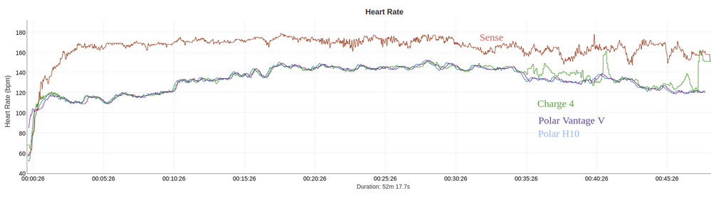

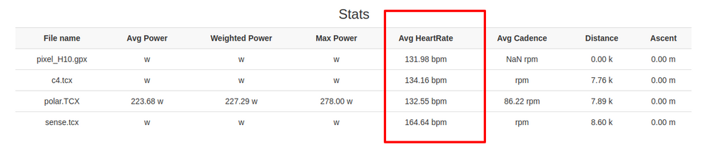

Below is my test
Comparison: Fitbit Sense (left wrist), Fitbit Charge 4 (right wrist), Polar Vantage V (right wrist), Pixel phone reading Polar H10 chest band
You can see that Polar optical sensor matches almost identical the reading of the chest band (so yes, it is definitely possible to compare measures from different sensor type), Charge 4 (using the old type sensor) is definitely good until 35 mins (a problem that I find quite often in Charge 4, probably the different sweating level affect the reading) while the Sense (using the latest HR sensor by Fitbit) is completely wrong (up to 40 points difference, the average reading provided is higher than the maximum heart rate)

@Rich_Laue yes the two technologies are completely different but are measuring the same entity (in this case heart rate) hence it is definitely legitimate compare the results. It is like when you weigh a body you can use a scale (hence technically measuring the mass of the object) or a dynamometer (hence measuring the weight, aka the force the body is attracted to the center of the earth); two completely different system but at the end, to be useful, need to provide the same result.
Now back to the topic.
Fitbit decided to adopt exclusively the optical heartrate sensor and in fact it is not possible to use any external sensor. This means Fitbit is really confident about the reliability of the results given by its Purepulse 2.0 (the sensor used in Sense/Versa 3).
Below is my test
