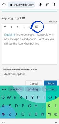

@gpk111 this forum doesn't let people with only a few posts add photos. Eventually you will see this icon when posting.

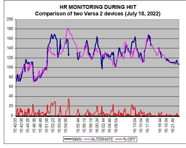

Here is part 1 (of 2) to describe my accuracy investigation of (in my case) Versa 2. I actually have 2 Versa 2 units, so I wore them both during HIIT. One on each wrist. Not bad, but not very useful to check instantaneous heartrates reliably.
Note gaps in the readings. Sometimes there are no readings.
The grapph at the borrom shows the % difference of the two units.

This is part 2 (of 2) my HR accuracy analysis. Data is based on HR downloads from the squash site, not the session downloads from Fitbit mentioned on this thread. The squash site acctually extracts its data from the fitbit database.
The graph shows that sampling rates vary from 1-3 seconds at very high HRs (say 150-180) to 5-15 seconds at "normal" HRs. The concept and design seems right, but instantaneous accuracy probably suffers because of movement and skin contact.
