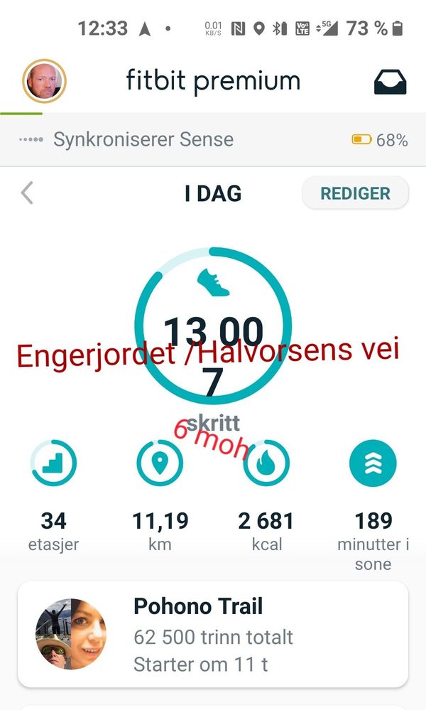

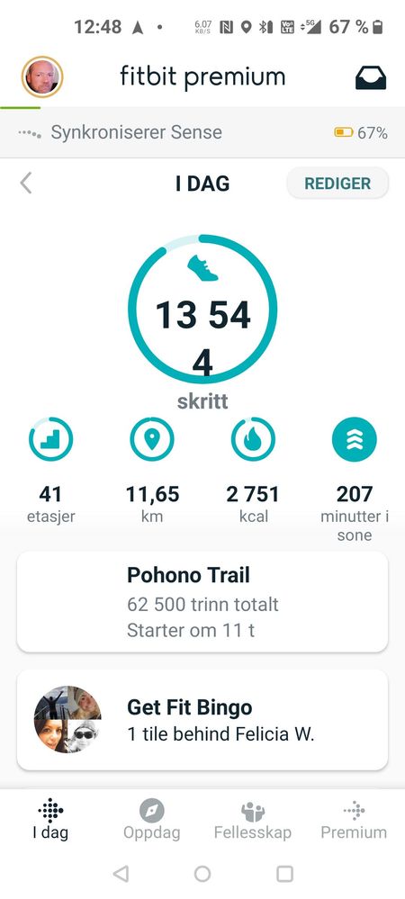

I got a new Sense on wednesday. Floor count is spot on. In the first screenshot I am 6 moh(meters above sea level) - I walked a steep hill up to 34 moh. = 28 height meters. 1 floor is 3 meters. Started at 34 floors, ended at 41, and that is as correct as it can be.
