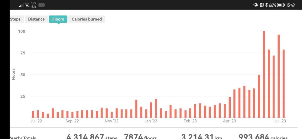

Since ther is no solution given in the community I post my data with the floor count.
As you can see the floor count gradually rises to unpresedented high since april 2023. My average high count should be about 20 floors. No way I'm doing over 70 floors each day.

@DramaQueenDiva I can imagine wind might have some effect, but not this much.
Going to the grocery: 15 floors. Walking at a flee-market: 16 floors. If that is the case then can't trust it anymore.
What makes me curious is that it is happening since april/may this year. Never before. Were there any updates on the fitbit Sense?

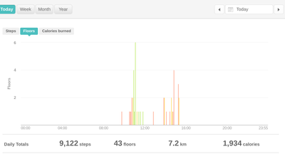

@Guy_ I'm having the latest version.(unfortunately)
Your SimpleFloors tells me I'm having a variety of pressure of about 10Pa up to 50Pa.
I can test it when I'm outside, but there's no telling when it happens, like today:
This 8 floors is at the end of a run/walk.
I'll try to give it a factory reset.
