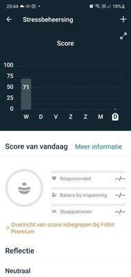

I have used my Sense daily for over two years but over the last three days my stress management score is no longer displaying. I only take my watch off to shower and charge so I basically wear it 23.5 hours a day. My sleep habits haven’t changed either. I tried a hard reset on the device and checked for both sense and app updates but my devices are both updated and the hard reset did nothing. It’s strange how much I’ve come to rely on that score but it really gives me some meaningful information. Please help if you have also had this issue.

Hi. I have done everything listed. I wear my watch 24 hours a day. I only take it off to shower every other day. I take 15000 steps a day and yes my heart rate is tracking. Everything is up to date. I have try to remove the stress tile and add it back. Logged in and out. Restarted phone and fitbit. Uninstaller app and reinstalled app. Also tried cleat cache. It stopped on Feb 8th. I have had no problem for a year. It says I need to agree to allow fitbit to use my information when you click the stress managment tile. But the agree button won't allow you to agree and you can not scroll up or down. I have an Samsung s10 plus. It's android based. Please help.

I am having the same issue. No problems with the Sense until Thursday February 10th when I had no Stress Mgmt score that day, nor any day since.
I meet all the stress management score requirements and have not changed my routine or habits so there's no reason it should have stopped. Sense is synching all other content fine.
I have force-closed the app, cleared the cache, rebooted the phone, restarted the Sense, and tried removing the tile and adding it back. Nothing worked.

I check the stress management score every day although I didn't get a score since 2/9/2022 and this morning I looked at the score for the month and there were scores for the week February 8 until 16 which I didn't had at that time. I don't know when the scores showed up because I normally check only the day and not the month.
