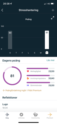

Hi, thanx for the support. No, my score for the last days did not show up…
