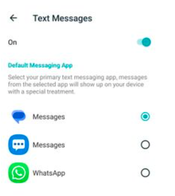

@DMW118 Samsung has its own texting app that is the default on those phones. Samsung doesn't always play nicely with Google/Fitbit. On your daughter's phone, tap on the device icon in the upper left of the Fitbit app and then select her device, you'll have the option to view and edit the notification settings.
Select "Text messages" and you should get a screen that looks something like this
The first Messages app is Google and the second is Samsung. If your daughter is currently using the Samsung Messages app, I would recommend switching to the Google app and see if that works better with the Fitbit app. She would need to switch to Google Messages on her phone, as well as in the Fitbit app.

We are both using the Google Messages, and have been for months. It is switched in the Fitbit app as well.
Notifications work fine normally, just not in the capacity I described above.
